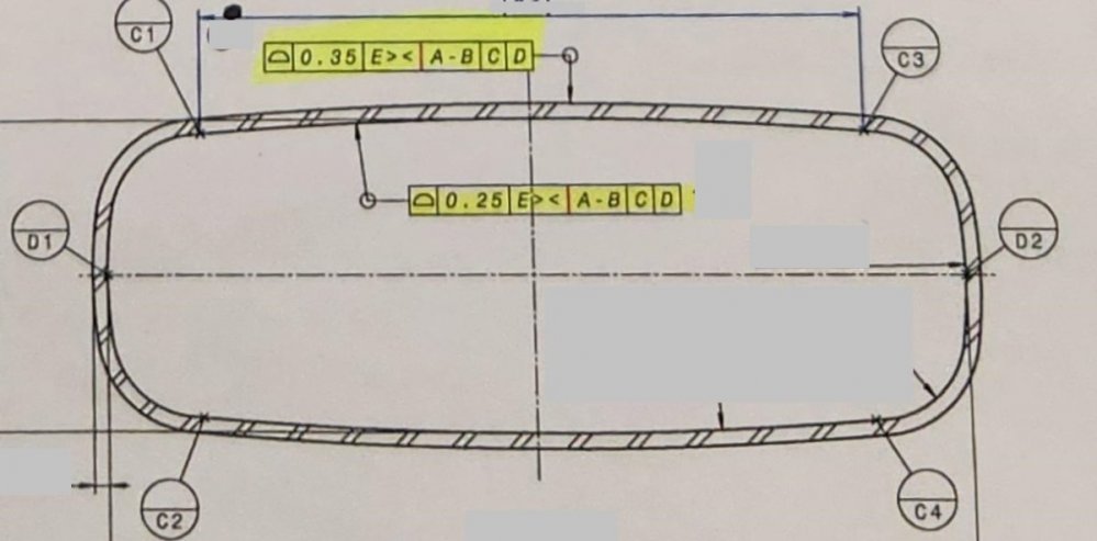

[Jo...] Posted December 18, 2024 Share Posted December 18, 2024 So I have the two callouts you see. This was a cut section of a surface that has about 25mm depth. Think ice hockey boards. So I did a 2DCurve around the inner and outer surfaces. But this doesn't really fulfill the surface profile. Would adding another curve at another level to both the inner and outer and the compiling them somehow into a FreeForm surface? I've seen colleagues just scan a 2D curve as mentioned and then report CurveForm but I don't think that's right. A-B is a stepped plane that is parallel to the section. I'm unsure of what the E>< in the feature control frame is asking. E is a datum that runs perpendicular to the section you see. It, E>< , shows up elsewhere on the print on a tapped hole true position callout of all things. Thanks in advance. Link to comment https://qualityforum.zeiss.com/topic/21554-profile-curve-form-feature-control-frame/ Share on other sites More sharing options...
[Ma...] Posted December 19, 2024 Share Posted December 19, 2024 This "><" mark should have meaning for direction only - but i can not confirm that now, not infront of my book. But surelly it won't be used as origin. Perhaps someone from Europe will came. That's rather newer version of ISO. Link to comment https://qualityforum.zeiss.com/topic/21554-profile-curve-form-feature-control-frame/#findComment-122882 Share on other sites More sharing options...

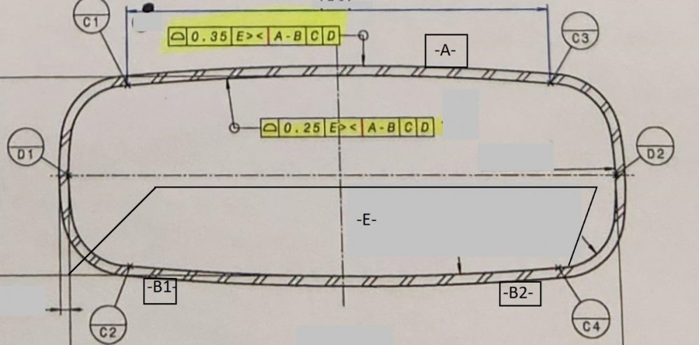

[na...] Posted December 19, 2024 Share Posted December 19, 2024 (edited) Please sign in to view this quote. What geometries are datum features E, A and B? And how are they placed? Edited December 19, 2024 Link to comment https://qualityforum.zeiss.com/topic/21554-profile-curve-form-feature-control-frame/#findComment-122888 Share on other sites More sharing options...
[Ke...] Posted December 19, 2024 Share Posted December 19, 2024 I'm guessing that "A-BICID" fully constrains the profile. The callout indicates "All Around"... so I would bet that the "E ><" might be indicating how much of the features height is required to fit the tolerance? Are there any indications in another view? Link to comment https://qualityforum.zeiss.com/topic/21554-profile-curve-form-feature-control-frame/#findComment-122904 Share on other sites More sharing options...
[Jo...] Posted December 19, 2024 Author Share Posted December 19, 2024 A-B are parallel to the section. They are stepped planes. -E- is a surface perpendicular 90° to the section that runs nearly the same length as the section Link to comment https://qualityforum.zeiss.com/topic/21554-profile-curve-form-feature-control-frame/#findComment-122906 Share on other sites More sharing options...

[Ke...] Posted December 19, 2024 Share Posted December 19, 2024 If you don't have FFS, then I would evaluate as Line Profiles using Curve, and report the Max result. Link to comment https://qualityforum.zeiss.com/topic/21554-profile-curve-form-feature-control-frame/#findComment-122910 Share on other sites More sharing options...

[Ma...] Posted December 19, 2024 Share Posted December 19, 2024 Please sign in to view this quote. Martin, great find. But I have a question on the OP post. If E sets orientation and not location then, in his case, A_B, C, D, constrain the 6 degrees of freedom that would override -E- as a primary or feature of orientation. just curious on your thoughts Link to comment https://qualityforum.zeiss.com/topic/21554-profile-curve-form-feature-control-frame/#findComment-122946 Share on other sites More sharing options...
[Ch...] Posted December 19, 2024 Share Posted December 19, 2024 I agree, but am not an ISO whiz... A-B being a stepped plane is another curve ball. Maybe constrain A-B + C to -E- individually then use those in a secondary alignment along with D and report profile to this ? Link to comment https://qualityforum.zeiss.com/topic/21554-profile-curve-form-feature-control-frame/#findComment-122950 Share on other sites More sharing options...
[Ma...] Posted December 19, 2024 Share Posted December 19, 2024 Please sign in to view this quote. My guess will be, that A-B will be primary, E>< wil be planar, rest with A-B will give only origin. Link to comment https://qualityforum.zeiss.com/topic/21554-profile-curve-form-feature-control-frame/#findComment-122954 Share on other sites More sharing options...
[na...] Posted December 20, 2024 Share Posted December 20, 2024 Please sign in to view this quote. Thanks for additional info. E >< will lock 2 rotational DoF, A - B will lock 1 rotation left (and 1 translation, but I don't see that translation will be used anyway), C will lock 1 translation, D will lock the last translation. Datum system looks legit, implementing in Calypso might be a challenge. Link to comment https://qualityforum.zeiss.com/topic/21554-profile-curve-form-feature-control-frame/#findComment-122968 Share on other sites More sharing options...
