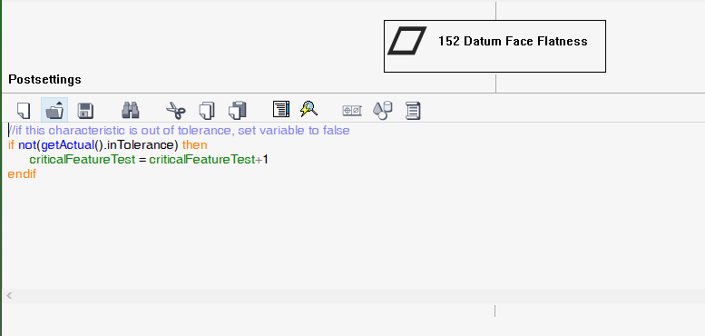

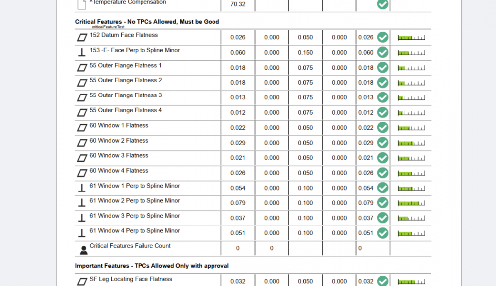

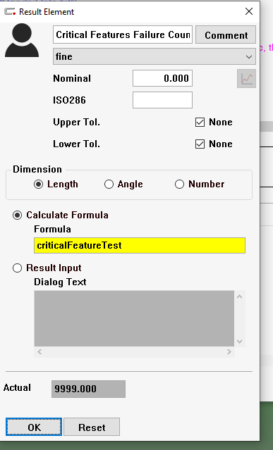

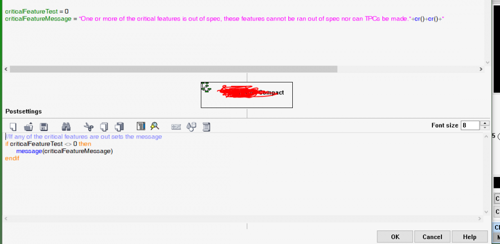

[Mi...] Posted January 6, 2025 Share Posted January 6, 2025 (edited) Like this? It's a similar request I had. You could fairly easily modify this for your needs. Program Pre and Post Settings Post Settings of each Characteristic to be included in the count. Paintbrush is your friend. Result element to display the count. Edited January 6, 2025 Link to comment https://qualityforum.zeiss.com/topic/21604-flag-rejected-accepted/#findComment-123348 Share on other sites More sharing options...

[Mi...] Posted January 17, 2025 Share Posted January 17, 2025 (edited) First, I accidently clicked report on Mr. Penrods post... I think I cancelled it but to any admin that may review. It was unintentional, I was trying to quote quickly and failed... Please sign in to view this quote. Neither of your solutions completely solve the request that was put to me when I did this, or I would have been much happier to simply use the external file. Your solution may solve the OP's question as it will act for the whole program, but that certainly doesn't mean what I did was over-engineered. I'm also curious if you can still get away with not using the characteristic name in the code when it's in an external file reliably? When I did that before I had issues, especially when the program was running in AutoRun - that was an older Calypso version though. #1 - I needed only a few of the characteristics in the program to have this, the engineer broke out the characteristics into 3 groups, Critical, Normal, and Reference Only. This code needed to act only on the Critical ones. The external file would act on all of them yes? #2 - Engineer wanted a count of how many of the Critical Features were OOT, which goes back to #1. #3 - Paintbrush tool to copy the post settings makes it only take a few seconds anyway Edited January 17, 2025 Link to comment https://qualityforum.zeiss.com/topic/21604-flag-rejected-accepted/#findComment-124588 Share on other sites More sharing options...

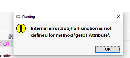

[Mi...] Posted January 21, 2025 Share Posted January 21, 2025 Please sign in to view this quote. I do like the idea of using Characteristic Attributes to denote this, however I've been down this road before and found that the getCFAttribute() doesn't seem to work as expected. It says "getCFAttribute(AttributeName) or (Characteristic name, Attribute name)" Okay so I put getCFAttribute("u_Operation") I get: So it seems I require the characteristic name, even though it says you don't, and even though the PCM manual says you don't. I add the characteristic name getCFAttribute("66 Diameter Ped. ID","u_Operation") or getCFAttribute(getNominal().identifier,"u_Operation"), both DO work and return the expected value. So I put this version " getCFAttribute(getNominal().identifier,"u_Operation")" in the external PCM file, and it fails due to not being able to correctly grab the characteristic name. So since you brought it up, how do you correctly use the getCFAttribute() function? I even copy this "OP_NAME=getCFAttribute("u_k0053operation")" right from the PCM manual and it doesn't work. Link to comment https://qualityforum.zeiss.com/topic/21604-flag-rejected-accepted/#findComment-124772 Share on other sites More sharing options...
