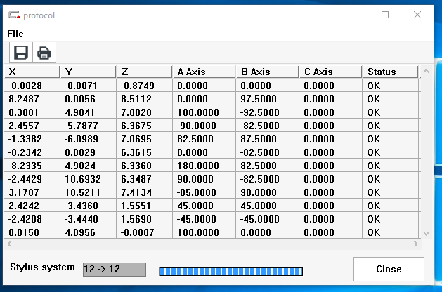

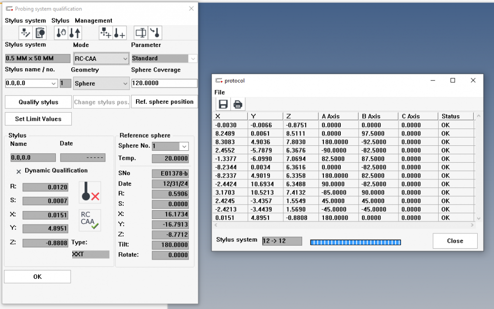

[AG...] Posted December 31, 2024 Share Posted December 31, 2024 My Question is i know i am missing something small and i cant put my finger on it? It wont calibrate the probe, but the RC-CAA is good? The end of run says it doesnt qualify? I am wondering is this something small i am missing? It is set on Sensitive and 30% pressure. Thank you for any feedback. Link to comment https://qualityforum.zeiss.com/topic/21622-05mm-x-50mm-calibration-issue/ Share on other sites More sharing options...
[DW...] Posted December 31, 2024 Share Posted December 31, 2024 Even with coverage set at 120°, you most like likely are still shanking out a 0.5mm probe on a 30mm sphere. You need to be using the 8mm sphere. This allows you to get 180° of coverage and not shank out. Your sigma value is 0.0007 inches, which is insane. This means you have no repeatability. I think the default sigma max before it won't qualify is 0.0004 inches, which is still really high. I would say absolute max I would want to see is 0.0001 inches for the sigma value. High sigma means you are shanking out, or your probe tip is damaged or loose. Also, switch to metric units when you qualify a stylus, or change decimal places to '5' for inch so you can really get down in the weeds. Link to comment https://qualityforum.zeiss.com/topic/21622-05mm-x-50mm-calibration-issue/#findComment-123150 Share on other sites More sharing options...

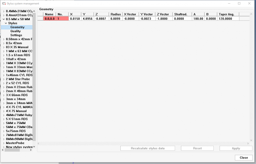

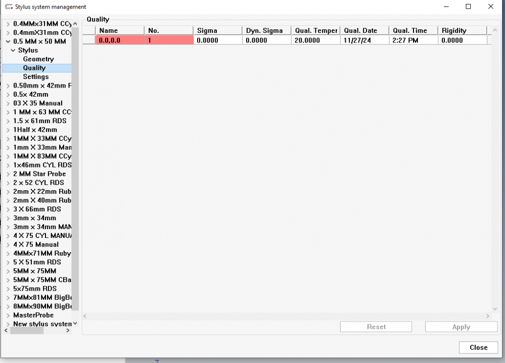

[DW...] Posted December 31, 2024 Share Posted December 31, 2024 Go into the Stylus System Management, find that probe, click to open up the Geometry, Quality, and Settings. Click on Quality. Screenshot that for us. Link to comment https://qualityforum.zeiss.com/topic/21622-05mm-x-50mm-calibration-issue/#findComment-123160 Share on other sites More sharing options...
[AG...] Posted December 31, 2024 Author Share Posted December 31, 2024 Here is what you are requesting to see and i took a screen shot of the recent numbers from Qual Link to comment https://qualityforum.zeiss.com/topic/21622-05mm-x-50mm-calibration-issue/#findComment-123168 Share on other sites More sharing options...

[DW...] Posted December 31, 2024 Share Posted December 31, 2024 Please sign in to view this quote. This is concerning. On November 27 of this year, someone tried to qualify this stylus and it failed (noted by the red color, and no values in sigma, dynamic sigma, and rigidity). If they said they got it to qualify, they are not telling the truth and that is the proof. Which is even more concerning, because I believe if you attempt to use a stylus that is not qualified, Calypso yells at you that you are using an unqualified stylus and they probably went ahead with it anyway. Reducing coverage to less than 120°, down from 180°, is not a good idea because then only a small portion of your stylus will be qualified and any measurements using an unqualified portion of the stylus are not valid. You need to get an 8mm stylus from Zeiss or stop using stylus systems with probes less than a 1.5mm radius until you do. Link to comment https://qualityforum.zeiss.com/topic/21622-05mm-x-50mm-calibration-issue/#findComment-123174 Share on other sites More sharing options...
[AG...] Posted December 31, 2024 Author Share Posted December 31, 2024 Please sign in to view this quote. Totally understand, yes i started just after this date. So i see what your getting at. I will look into the 8mm sphere. Link to comment https://qualityforum.zeiss.com/topic/21622-05mm-x-50mm-calibration-issue/#findComment-123176 Share on other sites More sharing options...
