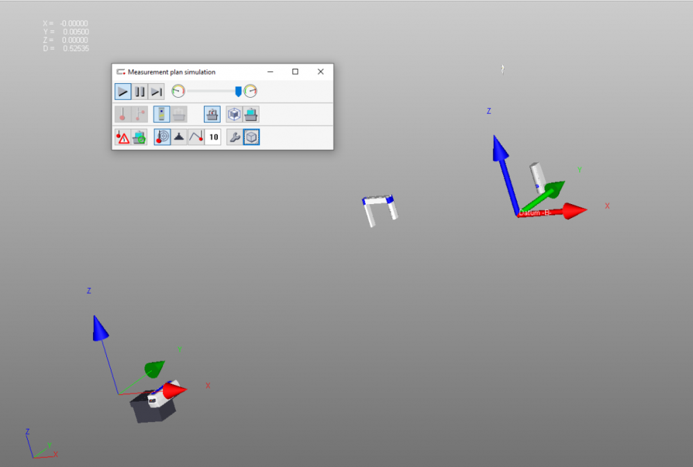

[Cl...] Posted January 3, 2025 Share Posted January 3, 2025 I opened planner and when I tried to run a simulation this happened. WTH? Why is my virtual CMM discombobulated? Link to comment https://qualityforum.zeiss.com/topic/21642-simulation/ Share on other sites More sharing options...
[Ri...] Posted January 3, 2025 Share Posted January 3, 2025 Try it without the CMM displayed and just use the surface plate shown. You may have to restart calypso. Link to comment https://qualityforum.zeiss.com/topic/21642-simulation/#findComment-123262 Share on other sites More sharing options...
[Cl...] Posted January 3, 2025 Author Share Posted January 3, 2025 Very strange. I clicked on CMM Operation, and the model went back together. Link to comment https://qualityforum.zeiss.com/topic/21642-simulation/#findComment-123264 Share on other sites More sharing options...

[No...] Posted January 7, 2025 Share Posted January 7, 2025 (edited) Don't worry. 🙃 If it happens again, "Set Base Alignment to Zero" should fix it. Edited January 7, 2025 Link to comment https://qualityforum.zeiss.com/topic/21642-simulation/#findComment-123404 Share on other sites More sharing options...
