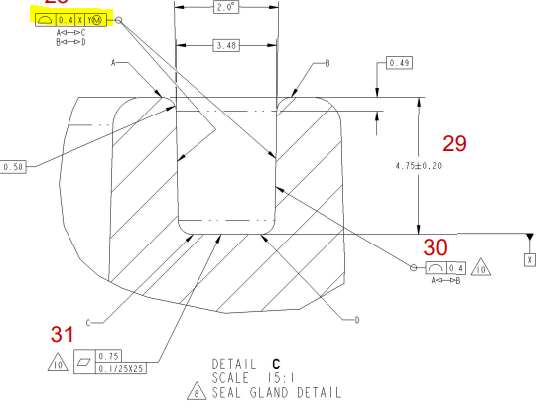

[Mi...] Posted January 6, 2025 Share Posted January 6, 2025 Working on a profile call that is to a -Y- datum (6x pattern of holes). Anyway to apply MMC from the features as the datum? TIA. Link to comment https://qualityforum.zeiss.com/topic/21656-mmc-from-best-fit-alignment-of-features/ Share on other sites More sharing options...

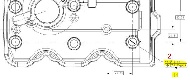

[Da...] Posted January 10, 2025 Share Posted January 10, 2025 I may be mis-understanding your question; I see a hole that is datum Y, but it's only 1 of 6 holes of that diameter. The positional callouts are ONLY to a 'primary' datum A, which I assume is the planar surface which these cylindrical features are perpendicular too? If that is the case, the callout is just a perpendicularity callout, to which I don't believe MMC can even be applied to since it is not a 'feature of size'. Perpendicularity does not change if the diameter varies, after all. If datum A is NOT the planar element (which is very unusual), then I don't have enough info to even have a clue. For the profile callout, what I read is that X is the 'planar' element, and the axis of Y is the perpendicular? So, maybe the cylinder locational discrepancy should be negated by the bonus tolerance and resulting datum shift , or else it will affect the profile? Frankly, this one makes my brain hurt...... Link to comment https://qualityforum.zeiss.com/topic/21656-mmc-from-best-fit-alignment-of-features/#findComment-123672 Share on other sites More sharing options...
[Mi...] Posted January 30, 2025 Author Share Posted January 30, 2025 Thanks for the feedback I will try the GD&T engine and see what that allows. I haven’t used it before so that will be a learning curve. Working with the engineering team on this as well. David, the Datum -Y- is the pattern of all 6 of the 13.18 cylindrical diameters, I do believe that calling it this way can satisfy all 6 degrees of freedom for the profile feature. I’m just not sure how to tell how much MMB is calculated from the size difference and what the equates to on the datum shift allowance. The software will calculate the profile as called, I just don’t see what the "bonus" shift is. To your point, the math is hurting mt head as well... Thank you both for the help. Link to comment https://qualityforum.zeiss.com/topic/21656-mmc-from-best-fit-alignment-of-features/#findComment-125348 Share on other sites More sharing options...
