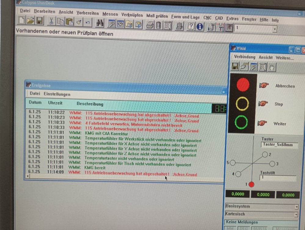

[Al...] Posted January 7, 2025 Share Posted January 7, 2025 I have error 115 and drivers OFF error Please help to solve it Link to comment Share on other sites More sharing options...
[Ky...] Posted January 7, 2025 Share Posted January 7, 2025 Hello Ali, What is happening when this is occurring? Are you trying to home? If so, do you have the offsets set correctly for the X, Y and Z axes (usually 5/-5/-5 or 10/-10/-10 mm)? I would think we'd see a different error for those, but maybe. If not, then I am guessing that this is likely to be a hardware related problem, especially if the drives are shutting off. The best course of action may be to contact your local ZEISS support and put a ticket in for their hardware team. Link to comment Share on other sites More sharing options...
[Da...] Posted January 7, 2025 Share Posted January 7, 2025 Make sure the air bearing paths are clean, wipe them off with a clean lint free cloth with alcohol. We had something like this happen when an operator put his hand on the bearing surface. Link to comment Share on other sites More sharing options...
[Ja...] Posted January 7, 2025 Share Posted January 7, 2025 Another reason could be insufficient air pressure. There are limits set to air pressure and if your air pressure drops below the low limit it would result in drives shutting off. I did this a long time ago based on Zeiss tech recommendation. I don't remember exactly but the pressure setting (reading you see on the digital readout of the valve) was close or same as the low limit (which I believe is 5.0) so any time the output pressure dropped even .1 it would shut off the drives. We increased the setting to 5.2 using the arrow keys and the problem went away. Link to comment Share on other sites More sharing options...

[Ow...] Posted September 10 Share Posted September 10 The documents provided by Kyle Johnson are good trouble shooting article's. If you're have trouble with the drives shutting off when moving the Z-axis on an older Duramax, I'll add that you do not have to take the 16 screws out to remove the Z axis cover to access the res-set switch on the Z drive motor. If you look closely with a flashlight, you can see the re-set switch and re-set it with a pencil or something skinny and long enough to reach it thru the vents at the top on the back side of the cover. I reset one yesterday and it's still running fine:-). Link to comment Share on other sites More sharing options...
