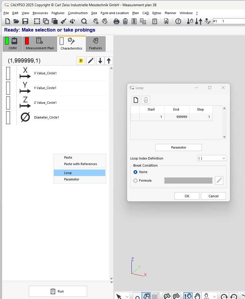

Is there a way to run a program continuously in a loop?
That was mentioned somewhere on forum.
Just right click on characteristic page to clear area ( having selected none of characteristics ) - there is loop.
Another approach i cycle in Autorun mode ( but that will come with protocols and evaluations )

Looping is also great if you are running a large set of parts, and don't want to have to constantly go through the 'RUN' screens. Just put a programmable stop in the CNC End Park Position, swap out the part, and hit enter on the controller and you're back to measuring.
  • Like! 1
If you press F8 on the joystick controller box, it will open the run window. Then, click the Lower Return to start the run. That eliminates in any interaction with the computer.
