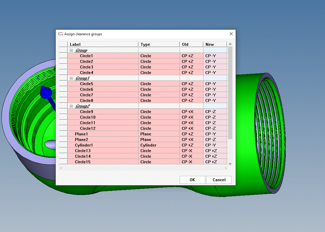

[Lo...] Posted January 8, 2025 Share Posted January 8, 2025 (edited) Hello, I am working on a part that I have had a proven program for that has worked great in the past. This time when I went to use the program all of my clearance planes have changed Z+ to Y- and so on. Why does this happen and how to do I change it back. I have been trying to manually change it in the clearance plane group and in the individual feature settings but the changes don't stay. I appreciate any assistance. Thank you. Lou Edited January 8, 2025 Link to comment https://qualityforum.zeiss.com/topic/21688-clearance-group-change/ Share on other sites More sharing options...

[DW...] Posted January 8, 2025 Share Posted January 8, 2025 Can you screenshot your base alignment or explain how you are clocking rotation on this part? Also, go to Plan>Navigation>Block edges.. and screenshot that too. Link to comment https://qualityforum.zeiss.com/topic/21688-clearance-group-change/#findComment-123558 Share on other sites More sharing options...
[Ke...] Posted January 8, 2025 Share Posted January 8, 2025 To clarify: Does the screen that you posted pop up whenever you open a program?? It should only open after creating a new base alignment, of modifying an old one. If it is a proven program, then there shouldn't be any need to modify it... curious. When it asks "Check definition of Clearance Plane - Update Clearance Plane Settings...", I always select "NO" and verify my Clearance Planes in the Feature Settings Editor. Link to comment https://qualityforum.zeiss.com/topic/21688-clearance-group-change/#findComment-123560 Share on other sites More sharing options...
[Ma...] Posted January 8, 2025 Share Posted January 8, 2025 Always select No when prompted with this prompt. There is no undo. However, you can change in mass on the Measurement Plan Editor Feature page. Travel/ Clearance Plane. Link to comment https://qualityforum.zeiss.com/topic/21688-clearance-group-change/#findComment-123562 Share on other sites More sharing options...
