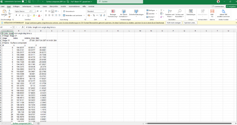

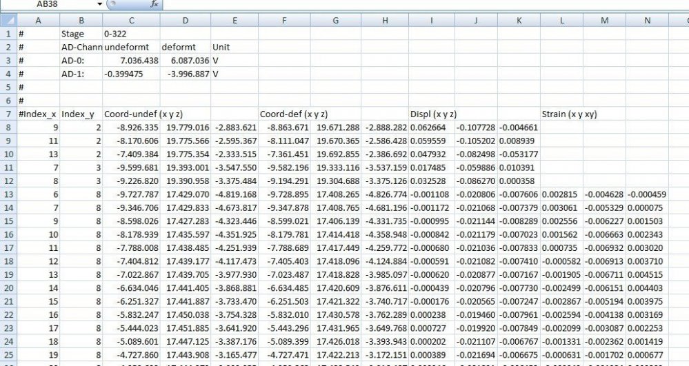

[Ma...] Posted January 9, 2025 Share Posted January 9, 2025 Dear all, in old versions of GOM-Aramis (i.e. Aramis V 6.3.0, GOM mbH, Braunschwieg, Germany) the set of facets was indexed using rows and columns (facets were part of a "Caretesian plane" and therefore eachone had a row and column index). Would it be possible to index the facets generated by Zeiss Inspect Correlate 2023 in the same way? Now it seems to me that the facet index is represented by a single progressive number. Thanks in advance Link to comment https://qualityforum.zeiss.com/topic/21700-data-export-with-csv-file-facet-indexing/ Share on other sites More sharing options...
[Mo...] Posted January 10, 2025 Share Posted January 10, 2025 Dear Massimiliano, when I export the facets for a specific stage by selecting the element in Explorer and File->Export->Stage Data I have a CSV file for the facets with their IDs and the position of each facet in Cartesian coordinates (x,y,z) the IDs are given as single numbers. Best regards, Mohamed Amer Link to comment https://qualityforum.zeiss.com/topic/21700-data-export-with-csv-file-facet-indexing/#findComment-123836 Share on other sites More sharing options...
[Ma...] Posted January 10, 2025 Author Share Posted January 10, 2025 Thanks Mohamed for the reply. Attached is an example file exported from the old version of the software. The "Cartesian" indexing was particularly useful to me for rapid local identification and for post-processing of the data. If anyone could tell me if it is possible to set this type of export format I would be grateful. Link to comment https://qualityforum.zeiss.com/topic/21700-data-export-with-csv-file-facet-indexing/#findComment-123858 Share on other sites More sharing options...
