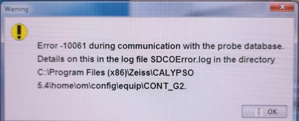

[Jo...] Posted January 13, 2025 Share Posted January 13, 2025 Hi, I had an operator stop a program after it stopped inside diameter of a part. Stylus was backed out with rcu and Calypso was rebooted after program would not run. After PC rebooted and Calypso start-up, These probe database connection errors are appearing. Does the the machine not like the position the RDS is in after reboot/program stop? Thanks in advance! Link to comment https://qualityforum.zeiss.com/topic/22072-rds-stylus-error-after-machine-stop-contura/ Share on other sites More sharing options...
[DW...] Posted January 13, 2025 Share Posted January 13, 2025 Please sign in to view this quote. Have you looked at the details in the log file at that location? Link to comment https://qualityforum.zeiss.com/topic/22072-rds-stylus-error-after-machine-stop-contura/#findComment-124184 Share on other sites More sharing options...
[Jo...] Posted January 13, 2025 Author Share Posted January 13, 2025 No I have not. When I follow these error log files in the past, they sometimes don't provide me with a intelligible lead. I decided to manually (with rcu) jog the head to a 90,0 position and re-booted PC and waited before I tried to start Calypso for a bit. (Older/slower PC and equally older version of Calypso.) The machine then connected without issue/errors. Not sure. Just a one-off of sorts. Thanks Link to comment https://qualityforum.zeiss.com/topic/22072-rds-stylus-error-after-machine-stop-contura/#findComment-124196 Share on other sites More sharing options...
[Ri...] Posted January 15, 2025 Share Posted January 15, 2025 Open Task Manager. Select Services. Look for "MSSQL$SDCO" If it is "Stopped", set it to "Run". Link to comment https://qualityforum.zeiss.com/topic/22072-rds-stylus-error-after-machine-stop-contura/#findComment-124352 Share on other sites More sharing options...
