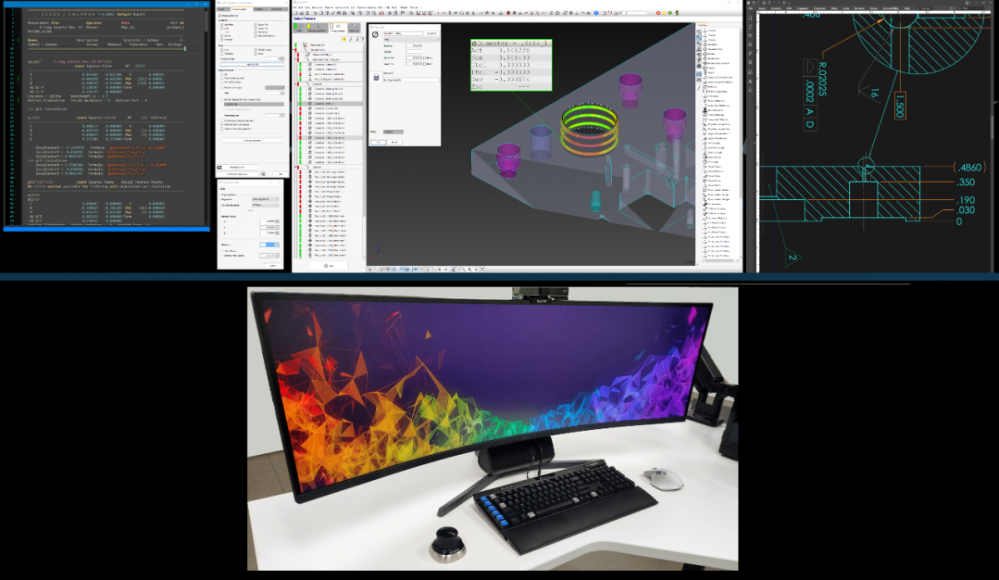

[Je...] Posted January 21, 2025 Share Posted January 21, 2025 Easy fix. Just get one monitor to rule them all. I also like to use scripts and a third-party app to help keep windows on my desktop organized and sized correctly. This has worked fairly well for Calypso, although I wish it were possible to undock Calypso windows from the parent application. Link to comment https://qualityforum.zeiss.com/topic/22084-calypso-2024-problem-fensterpositionen/#findComment-124746 Share on other sites More sharing options...
[To...] Posted January 21, 2025 Share Posted January 21, 2025 Please sign in to view this quote. I'm entertaining this idea.... Link to comment https://qualityforum.zeiss.com/topic/22084-calypso-2024-problem-fensterpositionen/#findComment-124750 Share on other sites More sharing options...
