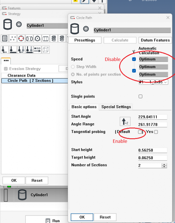

[Ri...] Posted January 14, 2025 Share Posted January 14, 2025 (edited) I can't recall how to disable this setting. For whatever reason, planner is the only seat that can use this setting. Edited January 14, 2025 Link to comment https://qualityforum.zeiss.com/topic/22090-disable-optimum-scanning/ Share on other sites More sharing options...
[Mi...] Posted January 14, 2025 Share Posted January 14, 2025 Is that not Navigator being turned on? Link to comment https://qualityforum.zeiss.com/topic/22090-disable-optimum-scanning/#findComment-124280 Share on other sites More sharing options...
[Ri...] Posted January 14, 2025 Author Share Posted January 14, 2025 I disabled that, it did not disable Optimum scanning. Link to comment https://qualityforum.zeiss.com/topic/22090-disable-optimum-scanning/#findComment-124284 Share on other sites More sharing options...
[Th...] Posted January 14, 2025 Share Posted January 14, 2025 Turning off the license for navigator should prevent those strategies from appearing. That's what I did years ago. Link to comment https://qualityforum.zeiss.com/topic/22090-disable-optimum-scanning/#findComment-124288 Share on other sites More sharing options...
[Ri...] Posted January 14, 2025 Author Share Posted January 14, 2025 I tried that, closed all programs, disabled Navigator, restarted Calypso (v2022). Nothing changed. Link to comment https://qualityforum.zeiss.com/topic/22090-disable-optimum-scanning/#findComment-124296 Share on other sites More sharing options...
[Ma...] Posted January 15, 2025 Share Posted January 15, 2025 What about Prepare->Save / Load defaults->Strategy - by checking on element you can edit default strategy for features. Link to comment https://qualityforum.zeiss.com/topic/22090-disable-optimum-scanning/#findComment-124322 Share on other sites More sharing options...
[Ri...] Posted January 15, 2025 Author Share Posted January 15, 2025 Please sign in to view this quote. That appears to have helped. Link to comment https://qualityforum.zeiss.com/topic/22090-disable-optimum-scanning/#findComment-124346 Share on other sites More sharing options...
