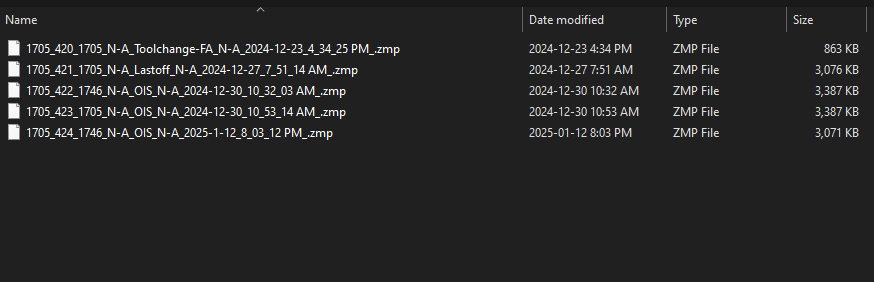

[Ni...] Posted January 14, 2025 Share Posted January 14, 2025 Hi All, On my saved programs, I have a folder named RUNS that is empty. We don't use the option to save probing points for each part run. Is this where these files would be saved? I would like to implement the option of having at least the last 10 run points saved for re-evaluation later on. Thanks in advance Link to comment https://qualityforum.zeiss.com/topic/22098-run-folder/ Share on other sites More sharing options...
[Je...] Posted January 15, 2025 Share Posted January 15, 2025 In the run-folder are mini-plans saved, if you have one. Link to comment https://qualityforum.zeiss.com/topic/22098-run-folder/#findComment-124314 Share on other sites More sharing options...
[Je...] Posted January 15, 2025 Share Posted January 15, 2025 To save points, you need to set in Resources->Results to File->Measuring Points on and set it to 10. A folder named "idmeaspoints" will be created, where your points will be saved. Sorry for my bad english, it´s early morning here 😬 Link to comment https://qualityforum.zeiss.com/topic/22098-run-folder/#findComment-124320 Share on other sites More sharing options...
[Mi...] Posted January 15, 2025 Share Posted January 15, 2025 When you turn the setting on, make sure you go into the "Name for output files" and format the file name into something useful for you otherwise you won't know which one to pick when you try to recall the data points. We put all the relevant header data in, and the date/time. Also, be aware of the file size. It adds up, especially long programs with lots of scanning. Link to comment https://qualityforum.zeiss.com/topic/22098-run-folder/#findComment-124356 Share on other sites More sharing options...
[DW...] Posted January 15, 2025 Share Posted January 15, 2025 Please sign in to view this quote. Personal preference, but I set it to 999 that way I don't overwrite any measurements accidentally. Link to comment https://qualityforum.zeiss.com/topic/22098-run-folder/#findComment-124364 Share on other sites More sharing options...
