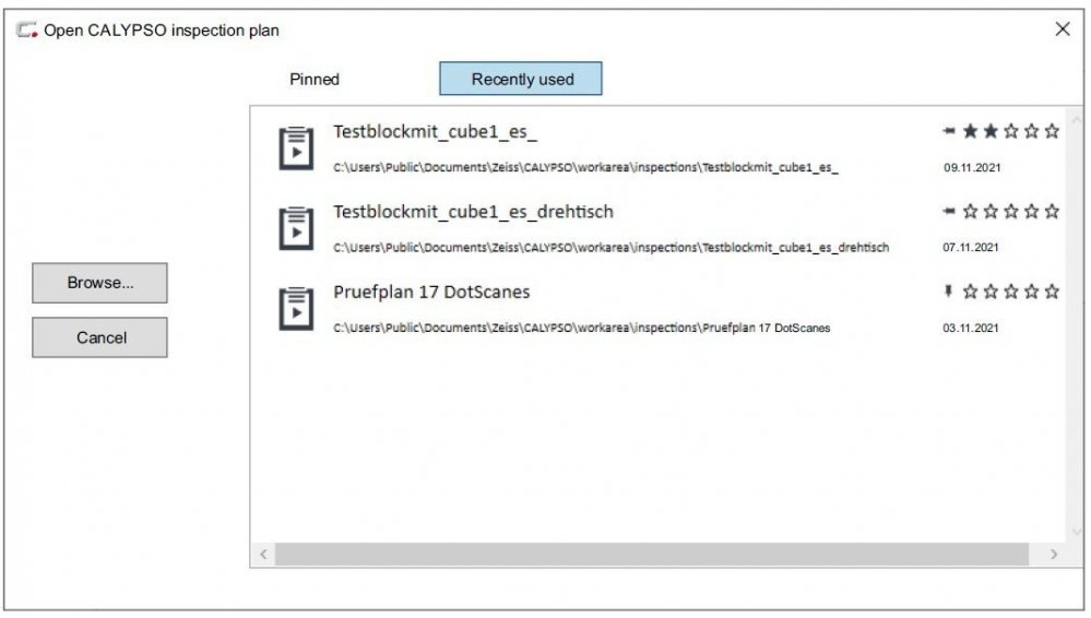

[Ma...] Posted January 16, 2025 Share Posted January 16, 2025 Hi. I accidentally closed the most frequently used programs window that appeared when opening a new plan. How can I restore it? Thank you Link to comment https://qualityforum.zeiss.com/topic/22118-how-to-restore-the-recently-used-programs-window-at-startup/ Share on other sites More sharing options...

[Je...] Posted January 17, 2025 Share Posted January 17, 2025 ZEISS Portal If one would like to disable the window you can “Right Click” > Don’t show favorites again. To undo this setting delete the CALYPSOFileDialog.exe folder located at C:\Users\<USERNAME>\AppData\Local\Carl_ZEISS_Industrielle_M (Note: AppData is a hidden folder, double check that you PC is set to View > Hidden Items.) Link to comment https://qualityforum.zeiss.com/topic/22118-how-to-restore-the-recently-used-programs-window-at-startup/#findComment-124586 Share on other sites More sharing options...
