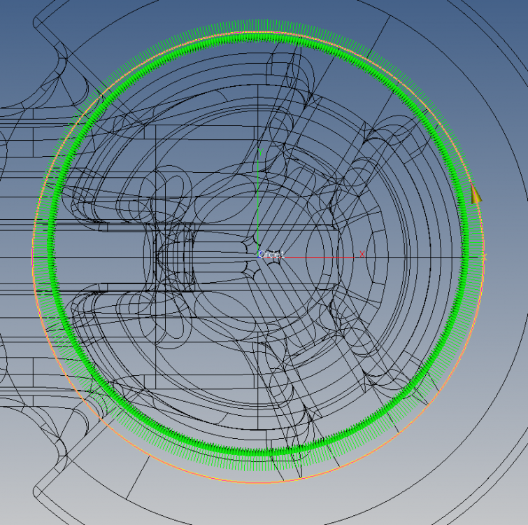

[Ri...] Posted January 16, 2025 Share Posted January 16, 2025 (edited) I'm using Calypso 2022 (v7.4.24) Planner and I see an issue with Actuals not aligned to Nominals. This is something that has crept up on me and now it is highly visible. Out of the 58 probes for Planner none of them align properly anymore, not even the MasterProbe. The Circle image was ran with the MasterProbe. Every feature created is not aligned from actual to nominals. All my nominals display perfectly on the model (Any model, any program). I create every program with pure geometry (Zero deviations less angled, compound angled features where I round to 8 decimals). This appears to be my Planner seat only. Anyone know what could be causing this and or how to fix it? Edited January 16, 2025 Link to comment https://qualityforum.zeiss.com/topic/22132-planner-actuals-are-not-aligned-to-nominals/ Share on other sites More sharing options...
[Pe...] Posted January 16, 2025 Share Posted January 16, 2025 It looks like you snuck a value into the constant displacement under settings->measurement->simulation Link to comment https://qualityforum.zeiss.com/topic/22132-planner-actuals-are-not-aligned-to-nominals/#findComment-124522 Share on other sites More sharing options...

[Ri...] Posted January 17, 2025 Author Share Posted January 17, 2025 Please sign in to view this quote. Good suggestion, but these are Zero and not enabled for all sensors. Link to comment https://qualityforum.zeiss.com/topic/22132-planner-actuals-are-not-aligned-to-nominals/#findComment-124558 Share on other sites More sharing options...
