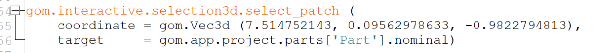

[Er...] Posted January 18, 2025 Share Posted January 18, 2025 Hi everyone, I would like to create a script that prompts the user to select a planar patch on the CAD. Then the script regain take control and create a plane on the patch programmatically. Or, as an alternative, if would you to build a generalized Construct > Auto Plane (Nominal)... dialog in a script, in such a way that the user can do the point selection on the CAD. Any help would be appreciated! Thanks a lot in advance. regards, Erik Link to comment https://qualityforum.zeiss.com/topic/22148-construct-a-plane-on-the-cad-from-a-dialog/ Share on other sites More sharing options...

[Er...] Posted February 3, 2025 Author Share Posted February 3, 2025 Hi James, Thank you for asking! I would like to let the script construct the midplane between two side surfaces of a gear. So the script asks the user to select surface #1, then surface #2 and then the script takes control again and constructs the midplane. I need the midplane to construct a section on the involute surfaces of the teeth. Best regards, Erik Link to comment https://qualityforum.zeiss.com/topic/22148-construct-a-plane-on-the-cad-from-a-dialog/#findComment-125492 Share on other sites More sharing options...

[Er...] Posted July 16, 2025 Author Share Posted July 16, 2025 (edited) Hi Nanno, Thanks for you reply. I used the option in the script editor to turn a fixed (recorded) selection into a prompted interactive selection. This turned out to work very well. Edited July 16, 2025 Link to comment https://qualityforum.zeiss.com/topic/22148-construct-a-plane-on-the-cad-from-a-dialog/#findComment-135269 Share on other sites More sharing options...
