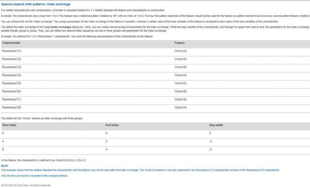

[Ri...] Posted February 18, 2025 Share Posted February 18, 2025 Please sign in to view this username. Do you know if it is possible to define your own custom Loop? I have a case where it's a pattern of 65, but 22 are omitted. On the feature side, this is easy, but is this possible on the characteristic side for the LOOP1 parameter? Link to comment https://qualityforum.zeiss.com/topic/22176-can-you-use-a-formula-to-select-a-feature-for-a-characteristic/#findComment-126724 Share on other sites More sharing options...
[Ch...] Posted February 18, 2025 Share Posted February 18, 2025 does this help? From Zeiss help file .. Link to comment https://qualityforum.zeiss.com/topic/22176-can-you-use-a-formula-to-select-a-feature-for-a-characteristic/#findComment-126734 Share on other sites More sharing options...
[Mi...] Posted February 18, 2025 Share Posted February 18, 2025 Every method I have tested requires the loop to be complete, and have a static step width... Entering the thought experiment stage: However... it occurs to me that you *might* be able to have multiple loops like this and still have it work? Haven't tried this... I'm not sure if the LOOP1 counter counts the loop value... or index number from the total... if that makes sense? If it counts value, this should work: hopefully your 22 omissions are in batches... But even if they aren't, and this works, it's still less work. You could potentially just pull the rotation value from the name of the characteristics...but that's more complicated PCM code and requires a Characteristics for each circle. Link to comment https://qualityforum.zeiss.com/topic/22176-can-you-use-a-formula-to-select-a-feature-for-a-characteristic/#findComment-126740 Share on other sites More sharing options...
[Ri...] Posted February 18, 2025 Share Posted February 18, 2025 The problem lies in the fact that for the feature name part of it, you would just want the standard counting of 1-43 for the LOOP1, but when I'm rotating the alignment via the Special option, I cannot use LOOP1 as the value actually has to be different. In that case I would need a custom defined LOOP where 1=1 2=2 3=3 4=5 5=7 6=8 7=10 etc.... Where the value on the left is the index count 1-43, but the value on the right is the actual value. I'm not certain this is possible or if it is, if it is worth it. I'm greatly appreciative for being able to use the LOOP1 function as much as I can. Link to comment https://qualityforum.zeiss.com/topic/22176-can-you-use-a-formula-to-select-a-feature-for-a-characteristic/#findComment-126770 Share on other sites More sharing options...
[Er...] Posted February 18, 2025 Share Posted February 18, 2025 Thats no problem at all, use a list. Eg: getParameterNamed(list(1,2,3,5,7,8,10),LOOP1) 1 Link to comment https://qualityforum.zeiss.com/topic/22176-can-you-use-a-formula-to-select-a-feature-for-a-characteristic/#findComment-126776 Share on other sites More sharing options...
[Ri...] Posted February 18, 2025 Share Posted February 18, 2025 Sometimes I question life and wonder if I made the wrong choices to lead me to where I am currently. Eric, that worked beautifully, and was way simpler than I thought it would be. Thank you, thank you, thank you. 1 Link to comment https://qualityforum.zeiss.com/topic/22176-can-you-use-a-formula-to-select-a-feature-for-a-characteristic/#findComment-126778 Share on other sites More sharing options...
[Mi...] Posted February 19, 2025 Share Posted February 19, 2025 Please sign in to view this quote. Humbled again! That solution is way better than what I was about to suggest. Eric... get on these forums more. We all enjoy learning from you. 1 Link to comment https://qualityforum.zeiss.com/topic/22176-can-you-use-a-formula-to-select-a-feature-for-a-characteristic/#findComment-126796 Share on other sites More sharing options...
