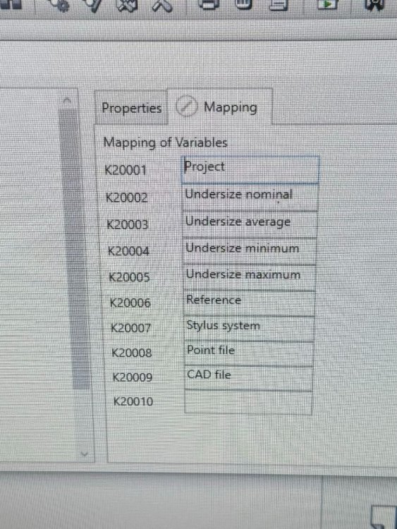

[To...] Posted January 23, 2025 Share Posted January 23, 2025 (edited) Customer has had 2 cmm's running with since September with a custom userfields.ini field with a single custom field "u_OperatorName", with a key mapping of K20001. Earlier this week, they noticed something had changed regarding the operator name in the header. They opened up the UserFields Editor and noticed something was seriously different. (see screenshot below). They opened up the userfields.ini file and it matched the editor. I'm not ruling out operator error, but customer claims no authorized users had made any modifications. And, I find it hard to believe this was randomly modified, but anything is possible. The names don't appear like a human entered the values. I mean they look like they could have originated from other text values else where in Calypso. Can anyone think of how the userfields.ini could be mysteriously modified? Edited January 23, 2025 Link to comment https://qualityforum.zeiss.com/topic/22210-corrupted-userfieldsini-file/ Share on other sites More sharing options...
[Ri...] Posted January 24, 2025 Share Posted January 24, 2025 Is there another PiWeb report that could be changing these? Like something someone is testing. Link to comment https://qualityforum.zeiss.com/topic/22210-corrupted-userfieldsini-file/#findComment-125052 Share on other sites More sharing options...

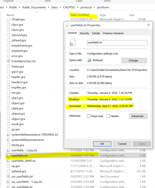

[DW...] Posted January 24, 2025 Share Posted January 24, 2025 Please sign in to view this quote. What's the "last modified" attribute for both files? Link to comment https://qualityforum.zeiss.com/topic/22210-corrupted-userfieldsini-file/#findComment-125056 Share on other sites More sharing options...
[To...] Posted January 24, 2025 Author Share Posted January 24, 2025 Please sign in to view this quote. I don't understand your question. Can you be more specific? Link to comment https://qualityforum.zeiss.com/topic/22210-corrupted-userfieldsini-file/#findComment-125058 Share on other sites More sharing options...
[DW...] Posted January 24, 2025 Share Posted January 24, 2025 Please sign in to view this quote. Link to comment https://qualityforum.zeiss.com/topic/22210-corrupted-userfieldsini-file/#findComment-125060 Share on other sites More sharing options...
[To...] Posted January 24, 2025 Author Share Posted January 24, 2025 DOH Unfortunately, customer opened the editor, which updated the "Accessed Date" and didn't think to check the properties for the modified date. Then, went about correcting the user fields and mapping in the editor. Link to comment https://qualityforum.zeiss.com/topic/22210-corrupted-userfieldsini-file/#findComment-125064 Share on other sites More sharing options...
