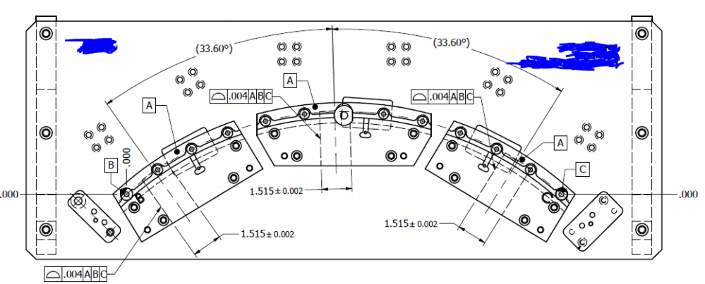

[AG...] Posted January 24, 2025 Share Posted January 24, 2025 I have this Profile of .004 ABC, i am drawing a blank and am not getting the answer i am thinking is correct. The profile is at .086, off the left wall of this cut out when i use my base alignment. Its been a long day so far and i am sure i am just missing something small here. My other question is when i make another alignment rotated around the Z axis with the 33.60 degrees and use a symmetry of the center cutout and then secondary and tertiary as my BC datums it comes out at .002. I feel like i am overthinking this alot. Thank you for your response. Link to comment https://qualityforum.zeiss.com/topic/22212-profile-of-a-surface/ Share on other sites More sharing options...
[DW...] Posted January 24, 2025 Share Posted January 24, 2025 (edited) Please sign in to view this quote. I am guessing A is a plane, B is a hole, and C is a hole? Create a line from B going to C and project that line to A. So A is spatial and Z origin, B is X and Y origin, and the projected line clocks rotation in +X. What does that result look like? Edited January 24, 2025 Link to comment https://qualityforum.zeiss.com/topic/22212-profile-of-a-surface/#findComment-125038 Share on other sites More sharing options...
[AG...] Posted January 24, 2025 Author Share Posted January 24, 2025 I did that and am still getting in the .070 profile Link to comment https://qualityforum.zeiss.com/topic/22212-profile-of-a-surface/#findComment-125054 Share on other sites More sharing options...
