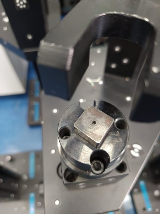

[Ed...] Posted January 28, 2025 Share Posted January 28, 2025 Hello, I need to create a point in the center of a diamond pin to use as RPS The pin is not a square and grey value did not work. My guess was trying to create one plane for each side and then create a middle plane for each pair of sides, but I didn't figure out how to create a middle plane from two other planes. Please, any suggestion? Link to comment Share on other sites More sharing options...
