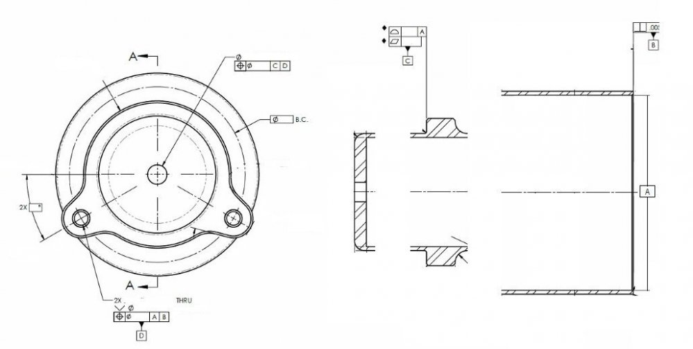

[To...] Posted January 28, 2025 Share Posted January 28, 2025 I used a Best Fit Bore Pattern Position of the 2 holes to A and B, allowing rotation, but how do you build a position of the center hole to Datum C and the Best Fit Bore Pattern? Link to comment https://qualityforum.zeiss.com/topic/22230-gdt-position-with-datum-feature-and-best-bore-pattern/ Share on other sites More sharing options...

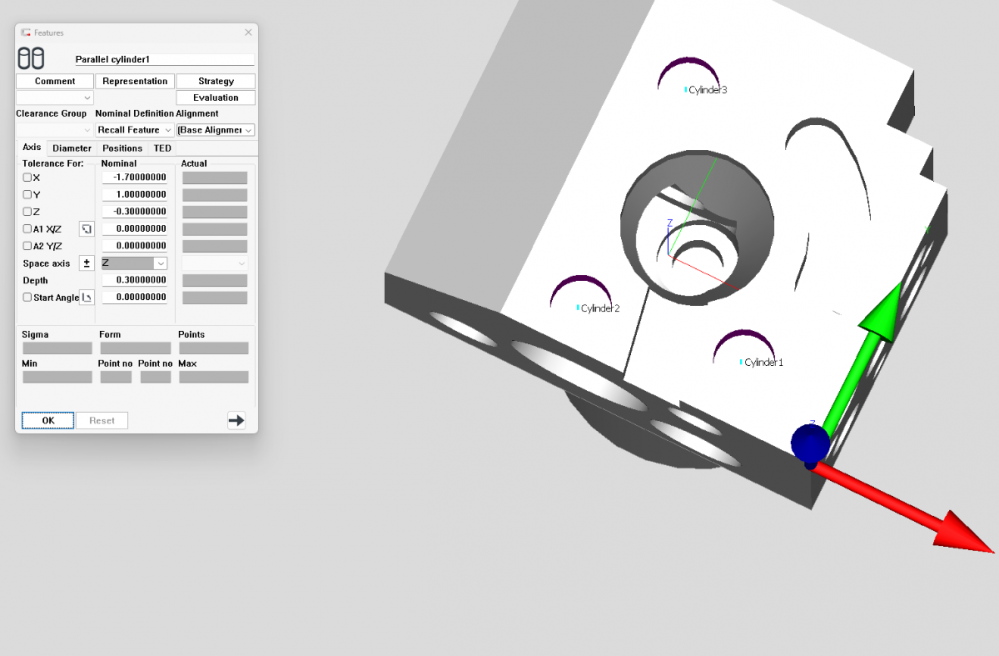

[Ky...] Posted January 30, 2025 Share Posted January 30, 2025 Hey Chris, It might be worth trying to use the "parallel cylinder" option under features. I haven't used it a hole lot, but I think this is the intended use case. Alternatively, you can try the new GD&T engine if you are using 2023 or newer and set these as a common datum. If the callout was like A|B|D, I would say just use the alignment from the bore pattern true position, but since it's a completely different alignment, these would probably be best. Link to comment https://qualityforum.zeiss.com/topic/22230-gdt-position-with-datum-feature-and-best-bore-pattern/#findComment-125426 Share on other sites More sharing options...
