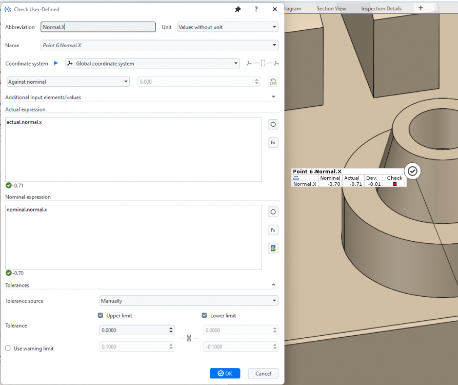

[Jo...] Posted January 31, 2025 Share Posted January 31, 2025 Hi, It's possible to check the normal of features? At another software was very useful check the ijk values from some features, it was automatic like xyz coordinates, for every feature you can pop up a label with xyz and ijk values. I can't find that values on zeiss inspect. Link to comment https://qualityforum.zeiss.com/topic/22276-how-to-chek-normalorientationijk/ Share on other sites More sharing options...

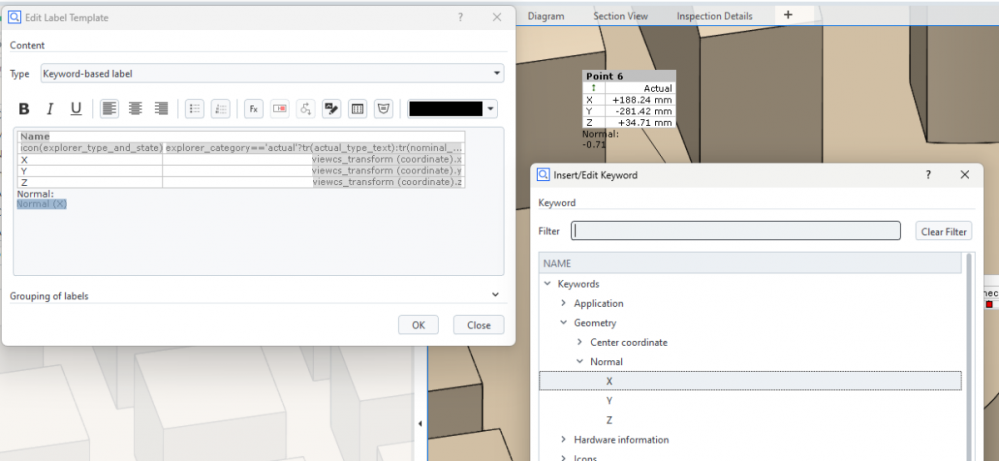

[Na...] Posted February 3, 2025 Share Posted February 3, 2025 Hello Jorge, this is not in a label as default but you can access the normal with element keywords in a label or with a user defined check: It is also possible to create a draft angle map: https://techguide.zeiss.com/en/zeiss-inspect-2025/article/cmd_comparison_create_multiple_draft_angle_map.html Nanno Link to comment https://qualityforum.zeiss.com/topic/22276-how-to-chek-normalorientationijk/#findComment-125530 Share on other sites More sharing options...
