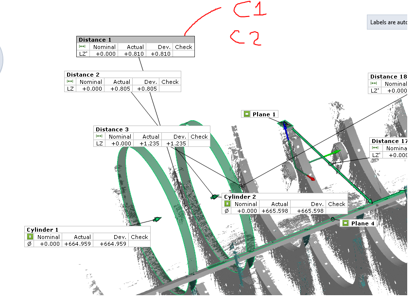

[Lu...] Posted February 1, 2025 Share Posted February 1, 2025 Hello to everyone! Is there a way to make the software display a distance positive or negative? I always get a positive distance even though I change the selection order... I would like to get the distance with a + or - according to a fixed center Between Cylinder 1 and Cylinder 2,I have a Z height difference of 0.81 mm, but I have many cylinders... How could I know which one is upper or lower than C1 (being this my fixed reference). All my distances are positive, but I'm sure there are some that should be negative when comparing to Cylinder 1... Thanks! Link to comment https://qualityforum.zeiss.com/topic/22278-how-to-obtain-a-positive-or-negative-distance-in-comparisson-to-a-fixed-center-line-in-z-axis/ Share on other sites More sharing options...
[Na...] Posted February 5, 2025 Share Posted February 5, 2025 Hi Luis, not sure how the distance was created, but would a nominal value (edit check -> against fixed value -> type in nominal value by hand) help you already? Link to comment https://qualityforum.zeiss.com/topic/22278-how-to-obtain-a-positive-or-negative-distance-in-comparisson-to-a-fixed-center-line-in-z-axis/#findComment-125696 Share on other sites More sharing options...
