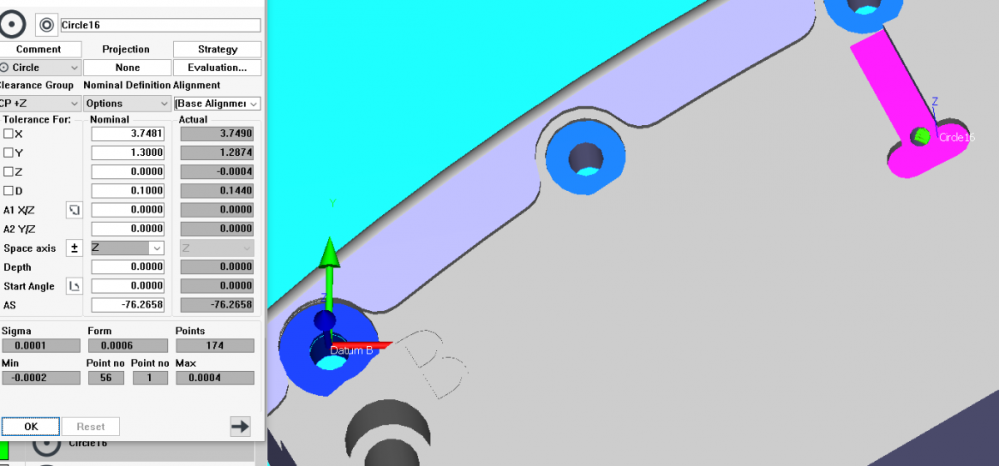

[AG...] Posted February 3, 2025 Share Posted February 3, 2025 Brain Fog here? The CAD Model and Calypso not matching up. I pick up the model and it is correct in DImension. I run the part and it shows off .010" Thanks for any help. Link to comment https://qualityforum.zeiss.com/topic/22294-hole-location-off/ Share on other sites More sharing options...
[AG...] Posted February 4, 2025 Author Share Posted February 4, 2025 Never follow the rabbit hole, i figured out my issue! CAD Model good always check for ID/OD when selecting a feature Calypso 101! Link to comment https://qualityforum.zeiss.com/topic/22294-hole-location-off/#findComment-125590 Share on other sites More sharing options...
