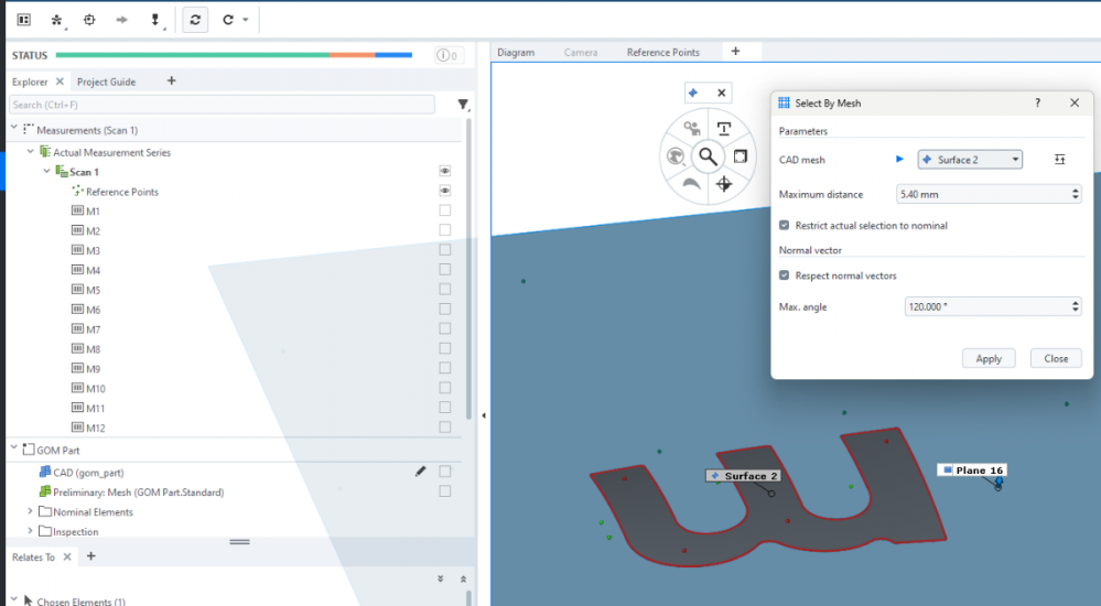

[Má...] Posted February 4, 2025 Share Posted February 4, 2025 Hello All! Is it possible to select reference points near around a fixture? (patch compound) Best regards, Máté Link to comment https://qualityforum.zeiss.com/topic/22298-reference-point-selection/ Share on other sites More sharing options...
[Na...] Posted February 5, 2025 Share Posted February 5, 2025 Hi Máté, it works with "select by mesh" and visible reference points: Nanno Link to comment https://qualityforum.zeiss.com/topic/22298-reference-point-selection/#findComment-125660 Share on other sites More sharing options...
