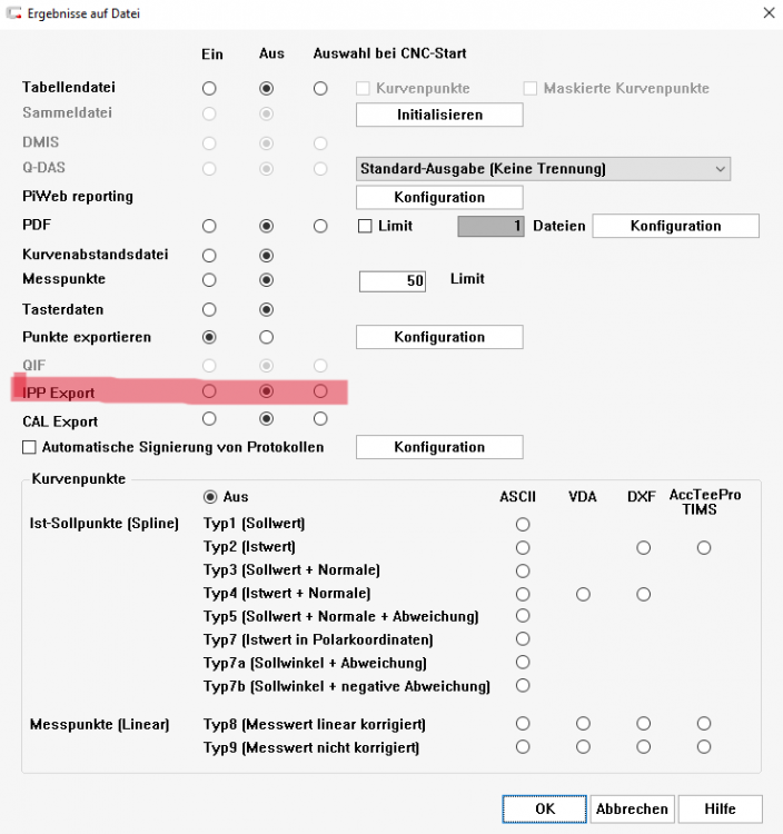

[Th...] Posted February 5, 2025 Share Posted February 5, 2025 Hello, We receive finished measurement plans from our customers as CSV/Excel files. We use them and load them into our Calypso program. If we want to export the measured actual values again, this only works if the customer sends us the file. If we try to export measurement data as a CSV list ourselves, it doesn't work. What can we do? The file is called “IPP” file and you can select it in “results on file..” and in “CNC start”. Link to comment https://qualityforum.zeiss.com/topic/22306-ipp-format-import-export/ Share on other sites More sharing options...

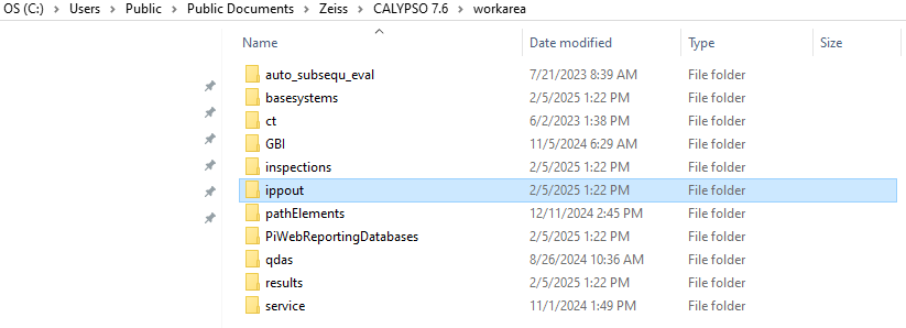

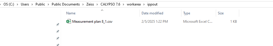

[Ri...] Posted February 5, 2025 Share Posted February 5, 2025 Please sign in to view this quote. The results will be stored in the workarea folder inside of a subfolder called ippout. Link to comment https://qualityforum.zeiss.com/topic/22306-ipp-format-import-export/#findComment-125714 Share on other sites More sharing options...

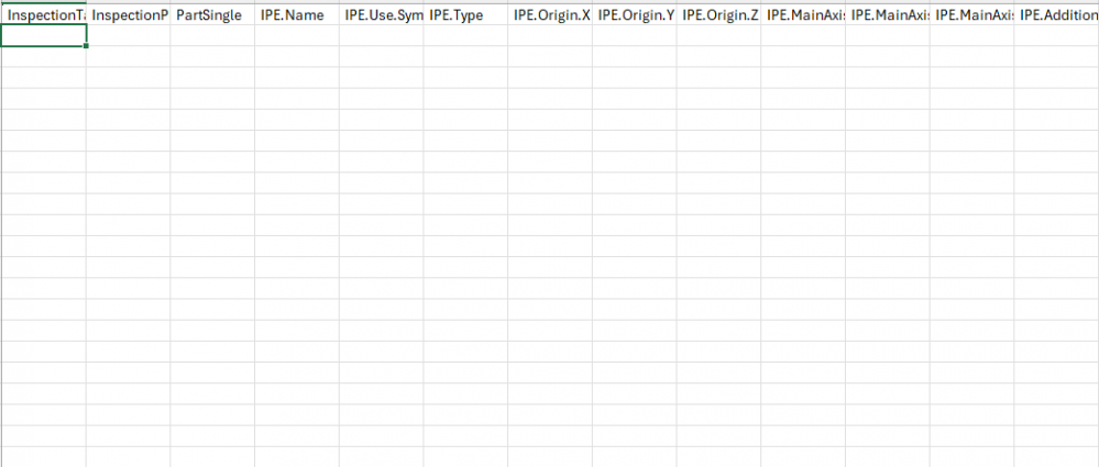

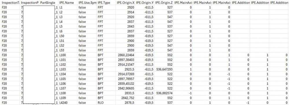

[Ri...] Posted February 5, 2025 Share Posted February 5, 2025 I see what you are talking about now. Reading the release notes from when it was implemented, it appears that a protocol file inside of the measurement plan has to be defined. You should probably ask your customer for this file because I am struggling to find any documentation over this. Link to comment https://qualityforum.zeiss.com/topic/22306-ipp-format-import-export/#findComment-125716 Share on other sites More sharing options...
