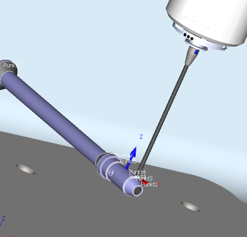

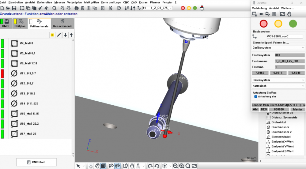

[Ma...] Posted February 6, 2025 Share Posted February 6, 2025 Good day, CMM colleagues, I’m currently experiencing some issues with my planner and would appreciate your support. As shown in the attached pictures, the probe is pointing towards X+ instead of Y+. Additionally, the three black dots on the plate (located on the left side) should actually be facing forward. I’m unsure what might be causing this misalignment and would greatly appreciate any guidance or suggestions on how to resolve the issue. Thank you in advance for your help! Best regards, Marco Link to comment https://qualityforum.zeiss.com/topic/22322-probe-is-pointing-in-the-wrong-direction/ Share on other sites More sharing options...

[Mi...] Posted February 6, 2025 Share Posted February 6, 2025 (edited) It's because it's a DuraMax, it's a visual thing that Zeiss STILL hasn't fixed apparently. On my planner seat, I setup all DuraMax's as an Eclipse with XXT and the 5/5/5 measurement volume. You don't get the CMM model but everything else works properly. It should fix this issue. Edited February 6, 2025 Link to comment https://qualityforum.zeiss.com/topic/22322-probe-is-pointing-in-the-wrong-direction/#findComment-125770 Share on other sites More sharing options...
[To...] Posted February 6, 2025 Share Posted February 6, 2025 (edited) I got tired of not having a clear and quick "work around" for this, so I created one. Setting up Star Probe for DuraMax in SSC.pdf Edited February 6, 2025 Link to comment https://qualityforum.zeiss.com/topic/22322-probe-is-pointing-in-the-wrong-direction/#findComment-125776 Share on other sites More sharing options...
