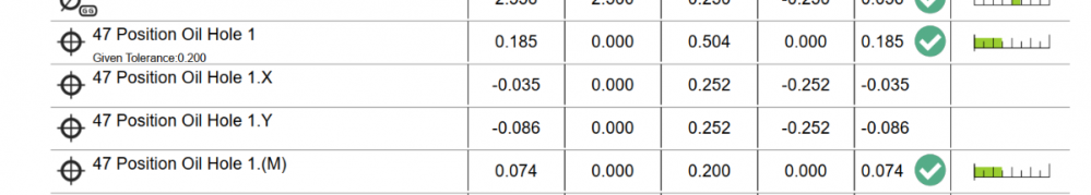

[Mi...] Posted February 7, 2025 Share Posted February 7, 2025 (edited) Zeiss certainly has picked a strange method for showing .M in what should be an SPC friendly way, but it fails in a completely standard compliant callout and they make it difficult to hide so you can not confuse people. It's (actual result/Total Tolerance)*Base Tolerance, and then it reports it as if it was your Base tolerance. so in your case (0.006/0.245)*0 Which will give you a 0 actual and 0 tolerance in the .M characteristic. In my result, here's one that works "properly" (0.185/0.504)*0.2 = 0.07341.... so it reports 0.074 at a 0.2 micron tolerance in the .M characteristic. Ford has something called the RTM Method that works in all cases. It's a bit more complicated to wrap your head around but it always works. So if you want the result in a text file just put the formula in, or better yet, use a different one that will always work, especially if you have 0(MMC) often. Edited February 7, 2025 Link to comment https://qualityforum.zeiss.com/topic/22336-single-values-of-a-result/#findComment-125874 Share on other sites More sharing options...
