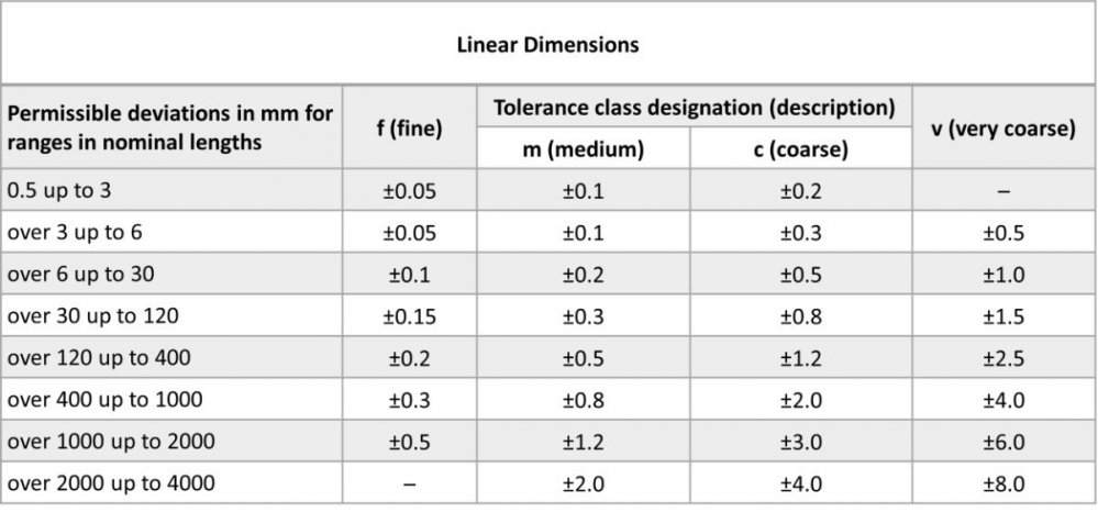

[Ni...] Posted February 7, 2025 Share Posted February 7, 2025 Good Morning All, Real basic question here. What is the difference between FINE and MIN MAX in the strategy? Thanks Link to comment https://qualityforum.zeiss.com/topic/22344-fine-vs-min-max/ Share on other sites More sharing options...
[To...] Posted February 7, 2025 Share Posted February 7, 2025 Fine is a classification for tolerancing in ISO based on the size of the dimension. MIN MAX is just the minimum and maximum tolerance. Link to comment https://qualityforum.zeiss.com/topic/22344-fine-vs-min-max/#findComment-125932 Share on other sites More sharing options...
