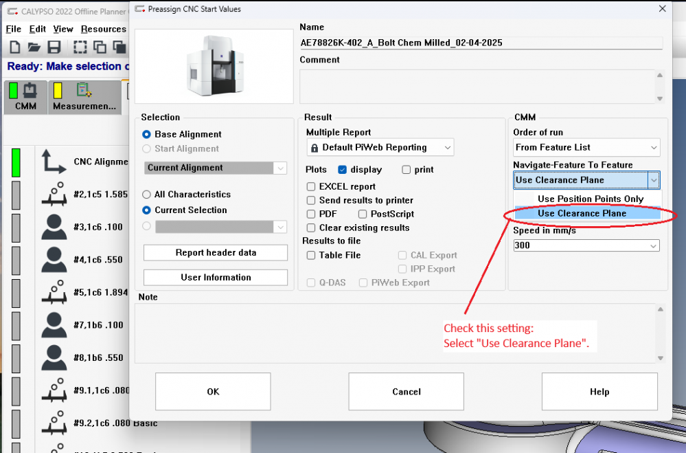

[Vi...] Posted February 10, 2025 Share Posted February 10, 2025 machine directly moving in CNC without asking for safe clearance position, caution message is not displyaing Link to comment https://qualityforum.zeiss.com/topic/22354-caution-message-after-manual-alignment-and-how-to-add-machine-move-in-cnc-now-machine-directly-moving-in-cnc-without-machine-moving-to-safe-location/ Share on other sites More sharing options...
[Ma...] Posted February 10, 2025 Share Posted February 10, 2025 It's unclear what are you asking for. Normally there is no message show unless you are taking points manually. Link to comment https://qualityforum.zeiss.com/topic/22354-caution-message-after-manual-alignment-and-how-to-add-machine-move-in-cnc-now-machine-directly-moving-in-cnc-without-machine-moving-to-safe-location/#findComment-125990 Share on other sites More sharing options...
[Ri...] Posted February 10, 2025 Share Posted February 10, 2025 Just a guess. Check the setting at run time as shown in the image. Link to comment https://qualityforum.zeiss.com/topic/22354-caution-message-after-manual-alignment-and-how-to-add-machine-move-in-cnc-now-machine-directly-moving-in-cnc-without-machine-moving-to-safe-location/#findComment-126002 Share on other sites More sharing options...

[To...] Posted February 12, 2025 Share Posted February 12, 2025 (edited) Your question is not clear. Please share screenshot of Run window, Base Alignment window and clearance plane window Edited February 12, 2025 Link to comment https://qualityforum.zeiss.com/topic/22354-caution-message-after-manual-alignment-and-how-to-add-machine-move-in-cnc-now-machine-directly-moving-in-cnc-without-machine-moving-to-safe-location/#findComment-126262 Share on other sites More sharing options...
