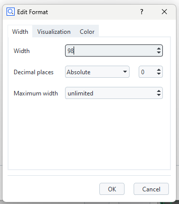

[Er...] Posted February 10, 2025 Share Posted February 10, 2025 (edited) Hello, Does anyone know where I can find the full syntax of the table expression keywords format and round? Regarding format, the Tech Guide states that the "field width" can be adjusted, but it doesn't explain how. The explanation regarding round is not clear. How can I round to 2 decimal places? Best regards, Erik Edited February 10, 2025 Link to comment https://qualityforum.zeiss.com/topic/22364-syntax-of-format-and-round/ Share on other sites More sharing options...

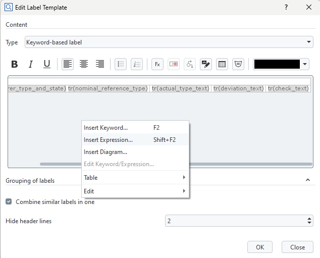

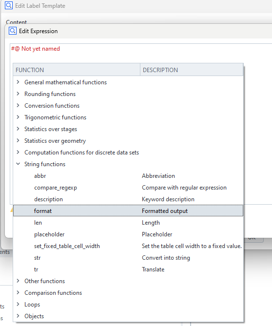

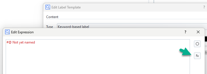

[Na...] Posted February 13, 2025 Share Posted February 13, 2025 Hi Erik, For the format expression, I recommend to use the Fx button in the expression editor and enter the values in the dialog. You can late edit them in the code: ... this will result in this code for example: format (VALUE, "+98.0", show_unit=false) For the rounding you could use Decimal places from the format() output. Link to comment https://qualityforum.zeiss.com/topic/22364-syntax-of-format-and-round/#findComment-126408 Share on other sites More sharing options...

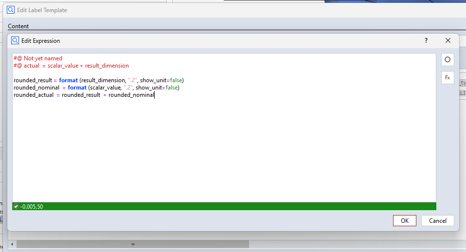

[Qu...] Posted February 23 Share Posted February 23 Hi Erik, This works for display purposes on individual values. I wondered if there was a way to round the value itself to enable further calculation with rounded values rather than a string operation. As you can see below attempts at addition simply add the string together. Link to comment https://qualityforum.zeiss.com/topic/22364-syntax-of-format-and-round/#findComment-146553 Share on other sites More sharing options...
[Jo...] Posted April 24 Share Posted April 24 Probably you should explicitly cast the string to floats. Link to comment https://qualityforum.zeiss.com/topic/22364-syntax-of-format-and-round/#findComment-149609 Share on other sites More sharing options...
