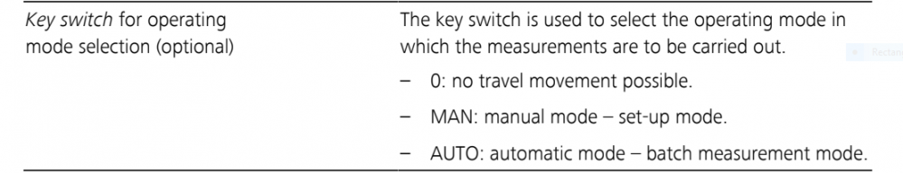

[Ja...] Posted February 10, 2025 Share Posted February 10, 2025 On my Contura G2 there is a key next to the emergency shut off button. There is 3 options for the key position, Man, O, and Auto. It is set to Auto. What is "O"? Does the machine run slower if the key is in the "O" position? Link to comment https://qualityforum.zeiss.com/topic/22366-contura-key/ Share on other sites More sharing options...
[Ma...] Posted February 10, 2025 Share Posted February 10, 2025 It should be for limiting speed - auto should be max of machine, man should be limited for 80 i think and 0 should be stop - no movement. Also that info should be visible whenever you want to start program ( for ex. Vmax = 80 ). Link to comment https://qualityforum.zeiss.com/topic/22366-contura-key/#findComment-126014 Share on other sites More sharing options...
[Ri...] Posted February 10, 2025 Share Posted February 10, 2025 (edited) Per the manual: Edited February 10, 2025 Link to comment https://qualityforum.zeiss.com/topic/22366-contura-key/#findComment-126016 Share on other sites More sharing options...
