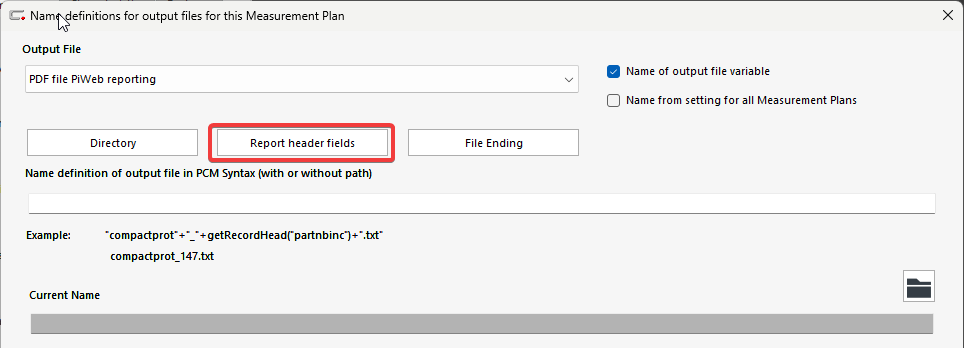

[Lu...] Posted February 11, 2025 Share Posted February 11, 2025 Hello. This is the equation I am using to automatically save PDF: "P:\Customer Folder"+"\"+getRecordHead("u_InternalJobNo")+"\"+getRecordHead("u_OpNo")+"\"+getRecordHead("u_SerialNo")+".pdf" As you can see, I am saving Serial No, which doesn't automatically index. Instead, I would like to save Incremental Part Number, because Incremental Part Number automatically indexes after each run. I tried to alter my equation to u_IncrementalPartNumber and that didn't work. Any ideas? Also, how can I automatically saved measured points after a run? Thanks! Link to comment https://qualityforum.zeiss.com/topic/22394-automatically-saving-pdf-measured-points/ Share on other sites More sharing options...

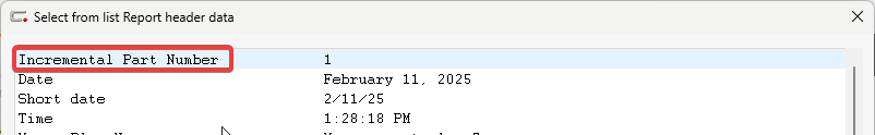

[Ma...] Posted February 11, 2025 Share Posted February 11, 2025 In same window there are three button - click "Headers" it will show you all possible from headers - just pick up one with double click - it will place it at the end of path ( so don't forget to correct it ) Link to comment https://qualityforum.zeiss.com/topic/22394-automatically-saving-pdf-measured-points/#findComment-126174 Share on other sites More sharing options...
[To...] Posted February 11, 2025 Share Posted February 11, 2025 (edited) Please sign in to view this quote. At 5:00 marker, shows incremental part number. Measuring Points can also be saved using same path strategies, though I am not 100% sure if it works with PiWeb Reporting Plus. Edited February 11, 2025 Link to comment https://qualityforum.zeiss.com/topic/22394-automatically-saving-pdf-measured-points/#findComment-126176 Share on other sites More sharing options...
[Lu...] Posted February 11, 2025 Share Posted February 11, 2025 Incremental Part Number: +getRecordHead("partnbinc") Link to comment https://qualityforum.zeiss.com/topic/22394-automatically-saving-pdf-measured-points/#findComment-126186 Share on other sites More sharing options...
