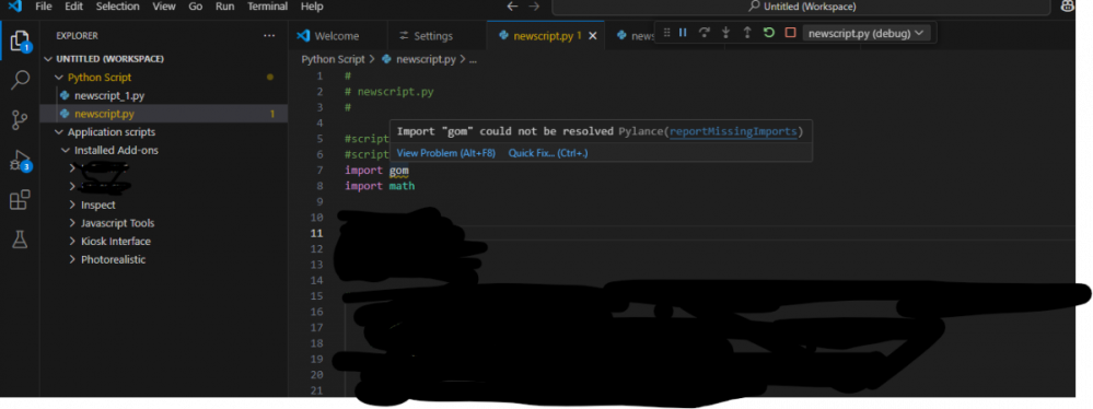

[Ky...] Posted February 11, 2025 Share Posted February 11, 2025 Hello, I was wanting to use an add on editor for my ZEISS code. I am following the Add-On Documentation "Using Visual Studio Code as an add on editor". The host is connected but I have encountered an issue where it is not recognizing gom. Is this due to my filepath or another issue? Link to comment https://qualityforum.zeiss.com/topic/22396-import-gom-issue-with-add-on-editor/ Share on other sites More sharing options...

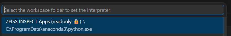

[Ma...] Posted August 29, 2025 Share Posted August 29, 2025 Please sign in to view this username. Thank you for your quick response! I had only found the older guide to setting this up, so thank you for the link. I ended up fixing the error on "import gom" by changing the interpreter to 3.13.7 instead of the 3.9 that it says in the guide. I'm guessing something has been updated to work with the new version, but the guide hasn't been updated yet. Thanks again! Link to comment https://qualityforum.zeiss.com/topic/22396-import-gom-issue-with-add-on-editor/#findComment-137701 Share on other sites More sharing options...

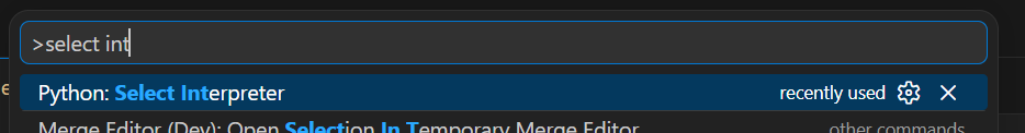

[GH...] Posted March 11 Share Posted March 11 I have the same issue and it used to work fine for one day and suddenly have issue importing gom. How to change the interpreter? I am not able to find the setting inside Inspect itself. Thanks. Exception has occurred: ModuleNotFoundError No module named 'gom' File Link to comment https://qualityforum.zeiss.com/topic/22396-import-gom-issue-with-add-on-editor/#findComment-147547 Share on other sites More sharing options...

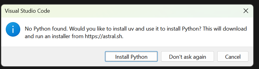

[De...] Posted March 26 Share Posted March 26 cntrl + shift + p but been getting this error too recently, reddit I clicked the dont ask again button... & connecting to zeiss inspect seems to resolve it ..not sure if its at all related, still using vscode w 2025. Link to comment https://qualityforum.zeiss.com/topic/22396-import-gom-issue-with-add-on-editor/#findComment-148292 Share on other sites More sharing options...
