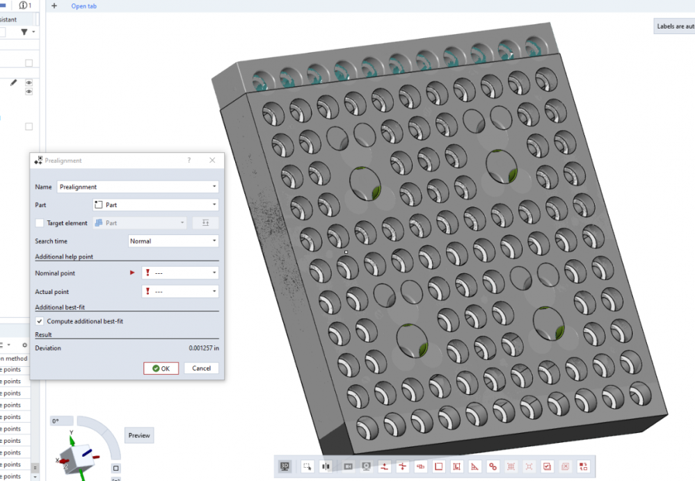

[Jo...] Posted February 11, 2025 Share Posted February 11, 2025 I am scanning a square plate with a bunch of holes in it. When I create the pre-alignment it ends up substantially shifted out of position to the CAD. I try to bring it in using local best fit but am having no success. What do I need to do to make this work? Please see attached. Link to comment https://qualityforum.zeiss.com/topic/22402-prealignment-local-best-fit/ Share on other sites More sharing options...

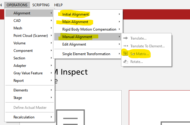

[Ja...] Posted February 12, 2025 Share Posted February 12, 2025 Hi, you can use both the main alignment and manual alignment. In this case, you can pre-align the item, then highlight it and use the main alignment. If the main alignment is still not perfect, you can switch to manual alignment. If your model has coordinates built in, you can select these coordinates and adjust them accordingly. (P.S. In your photo, the target element is not selected, so it's unclear what it's aligning to.) I really hope this helps! Please feel free to message me if you'd like further assistance—I'll try my best to help. 🙂 Link to comment https://qualityforum.zeiss.com/topic/22402-prealignment-local-best-fit/#findComment-126212 Share on other sites More sharing options...
[Ax...] Posted February 12, 2025 Share Posted February 12, 2025 Hi John, sometimes helps, if you use "additional help point": Click at one special point, maybe the corner left top on CAD und the same point on the mesh. Suddenly pre allignment works fine. Link to comment https://qualityforum.zeiss.com/topic/22402-prealignment-local-best-fit/#findComment-126224 Share on other sites More sharing options...

[Ti...] Posted February 13, 2025 Share Posted February 13, 2025 (edited) You need to set this up without a mesh for it to work. So delete the mesh. Create a Surface on the CAD model and click the top plane with all the holes on it, but don't click the holes. Then click the left side plane and the top side plane. All 3 of those planes become your surface. We are simulating a 321 alignment(Plane-Plane-Plane) Apply the measuring principle 'no measuring principle' Now in your prealignment picture you posted, do you see 'target element'? Click that on and in the drop down select the surface you created above. Click OK. Now bring in the mesh and it should line up nicely. You are telling the software what to look for to align to. If it finds those robust 3 plane which it should the part should be lined up. Otherwise you can start tying to use certain holes in the surface, but the planes should do fine. Edited February 13, 2025 Link to comment https://qualityforum.zeiss.com/topic/22402-prealignment-local-best-fit/#findComment-126466 Share on other sites More sharing options...
