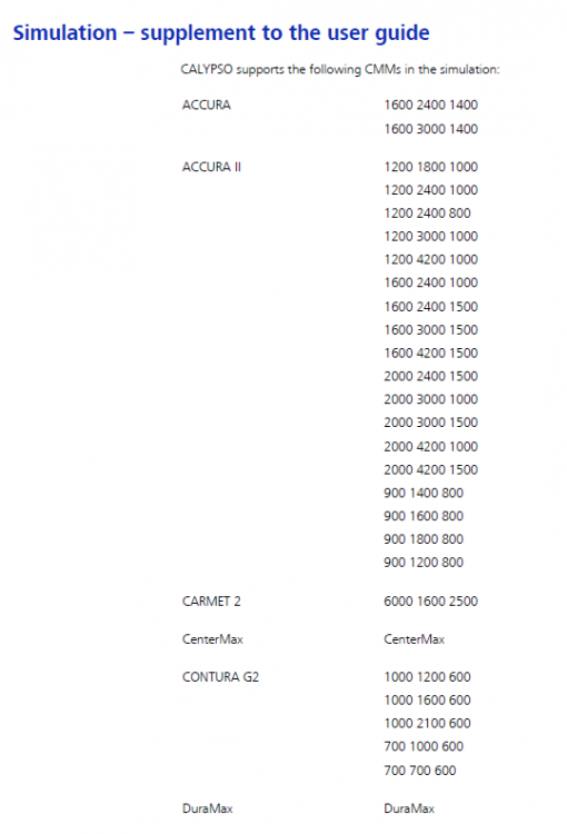

[Vi...] Posted February 13, 2025 Share Posted February 13, 2025 hello In, my simulation setup machine cad presentation is not available. please refer below snap. Link to comment https://qualityforum.zeiss.com/topic/22434-calypso-planner-display-cmm-contura-g3-122410/ Share on other sites More sharing options...
[To...] Posted February 13, 2025 Share Posted February 13, 2025 Are you talking about the part model or stylus systems models? If the latter, have you created your stylus systems in Stylus System Creator software? And, imported them into Planner? Link to comment https://qualityforum.zeiss.com/topic/22434-calypso-planner-display-cmm-contura-g3-122410/#findComment-126406 Share on other sites More sharing options...

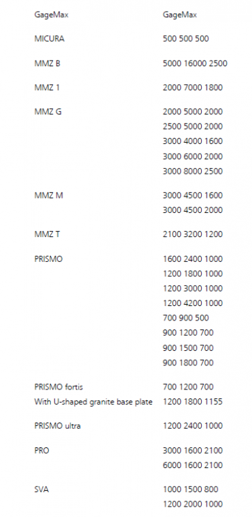

[Ma...] Posted February 13, 2025 Share Posted February 13, 2025 (edited) In the release Info you can find supported CMM Sizes for the Planner/Simulation. If you choose one of those supported CMMs with the correct size it should be available. Best Regards Marcel Edited February 13, 2025 Link to comment https://qualityforum.zeiss.com/topic/22434-calypso-planner-display-cmm-contura-g3-122410/#findComment-126412 Share on other sites More sharing options...
[To...] Posted February 13, 2025 Share Posted February 13, 2025 It seems odd that Contura is not listed above. Link to comment https://qualityforum.zeiss.com/topic/22434-calypso-planner-display-cmm-contura-g3-122410/#findComment-126426 Share on other sites More sharing options...

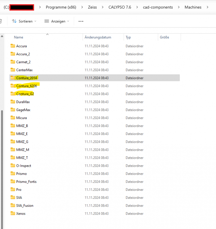

[Ma...] Posted February 14, 2025 Share Posted February 14, 2025 Hi Tom, i just checked, there are some more CMMs within the CAD components in the installation files, they "should" work aswell: Best Regards Marcel Link to comment https://qualityforum.zeiss.com/topic/22434-calypso-planner-display-cmm-contura-g3-122410/#findComment-126476 Share on other sites More sharing options...
[To...] Posted February 14, 2025 Share Posted February 14, 2025 Please sign in to view this quote. Thank you Marcel. I knew the Contura existed because I have it set up on my Planner. I was just surprised that it wasn't listed in the documentation. Link to comment https://qualityforum.zeiss.com/topic/22434-calypso-planner-display-cmm-contura-g3-122410/#findComment-126494 Share on other sites More sharing options...
