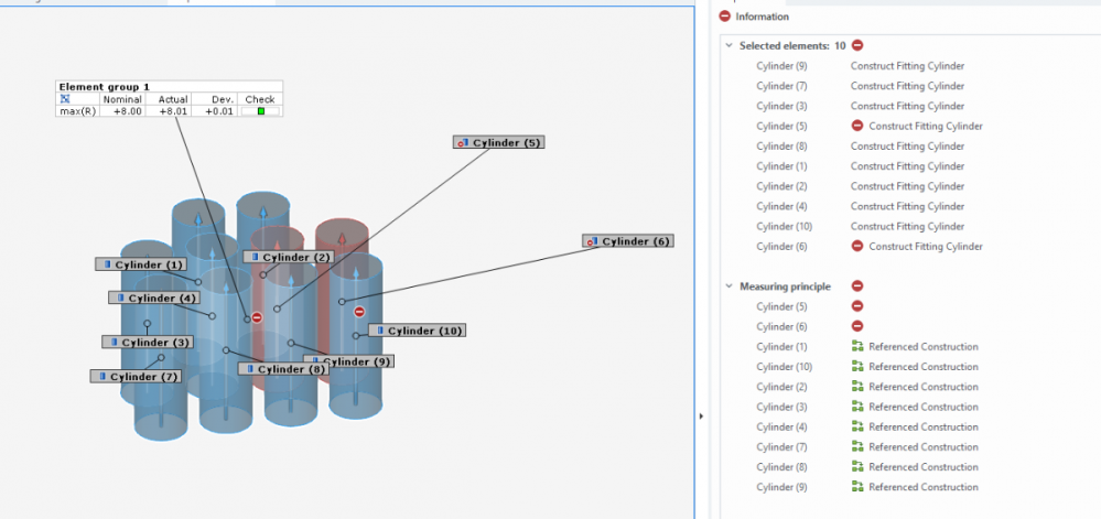

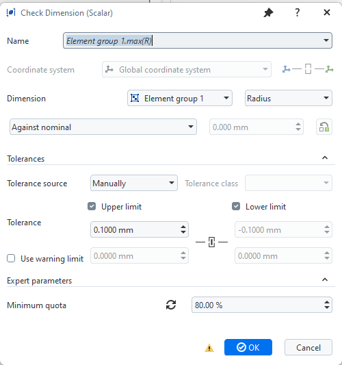

[Má...] Posted February 17, 2025 Share Posted February 17, 2025 Hello All ! I would like to know what the minimum quota function means exactly when I check a minimum distance for an element group. Best regard, Máté Link to comment https://qualityforum.zeiss.com/topic/22464-mimimum-quota/ Share on other sites More sharing options...

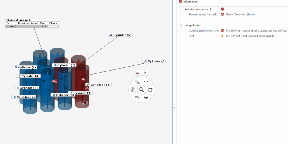

[Na...] Posted February 18, 2025 Share Posted February 18, 2025 Hello Maté, it is the percentage of elements in the element group, which are allowed to be invalid. If you have an element group of 100 points and a single one would fail due to a hole in the mesh for example, the check will be still calculated. <- 80% <- still works <-fails Link to comment https://qualityforum.zeiss.com/topic/22464-mimimum-quota/#findComment-126720 Share on other sites More sharing options...
