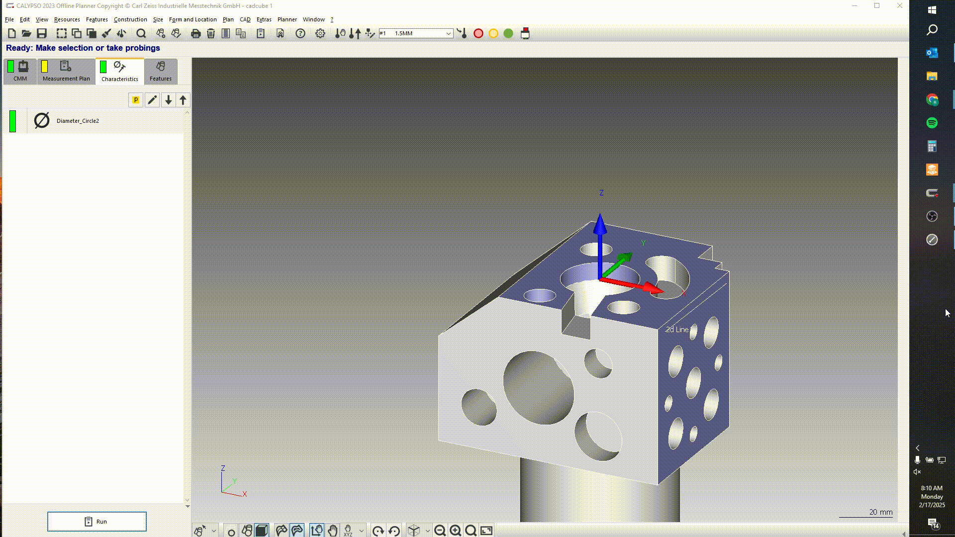

[Ri...] Posted February 17 Share Posted February 17 Good morning, Please remember that I'm not a PCM expert, so please do not rip me if this is a basic question - lol. Can you please explain this PCM behavior to me and why it does this? I just have a simple message() command on the pre-settings of the first feature, and a simple message() command on the post-settings of the last feature. So why does it run the message commands twice? Link to comment Share on other sites More sharing options...
[Je...] Posted February 17 Share Posted February 17 (edited) are these features part of a looped base-system? Edited February 17 Link to comment Share on other sites More sharing options...
[Ri...] Posted February 17 Author Share Posted February 17 (edited) Nope. Is this just a Simulation "bug" maybe? Edited February 17 Link to comment Share on other sites More sharing options...
[Mi...] Posted February 18 Share Posted February 18 (edited) Looped base alignment was my first guess too. Accidentally having it in the program Pre and post settings as well as the first and last feature would be my next (done that, wasted a lot of time before I checked that). #### Actually. I think the answer is, Base Alignment features are calculated twice. This is why you can use them for measurement. I've run into this using something like a getActual().z to check that the part is loaded correctly. The pre and post settings execute once immediately upon measuring, when the feature initially calculates. If this is a plane that should be controlling say X, A1 and A2. This first calculation will be relative to the saved base alignment, and the values won't be 0 like they likely should be. Then, all of it calculates again, when the Base Alignment computes as literally every single value is changed when the Base Alignment coordinate system gets calculated. At this point all the appropriate values will be 0. Quick proof of concept: Choose a feature that controls a translation DoF in the Base Alignment. I'll say X. In the Post settings of the feature put display(getActual().x) Increase the decimals to at least 4-5. Run the program on a real machine, let it at least fully finish the Base Alignment. Take note of the value that showed up in the display box. Double click the feature and look at X, it'll be different, likely 0 if it's controlling that DoF. You can also interrupt the Base Alignment with the stop light immediately after the feature, if you do this, the X value should match what shows in the display box So if you want to have a Base Alignment feature STOP running for any reason, you need to incorporate a cncBreak() or it will always want to finish the base alignment. Hopefully that works to show it, but I've run into that double calculation issue basically where the PCM code reacts to the first calculation. Was a big head scratcher because I would open the feature and the values wouldn't match. It wasn't until I made it write them all to a file and saw that everything updated it clicked. Edited February 18 Link to comment Share on other sites More sharing options...

[Je...] Posted February 28 Share Posted February 28 Please sign in to view this quote. In recent versions of CALYPSO, there is/was a bug for feature calculation for features in Base Alignment may iterate several times (3x) based on the requirement of the alignment (even without a loop). This is a known issue but I am unaware of its current status (it may have been resolved in Service Pack already). Make sure you are on the most current SP and I advise using a counter condition if this is a place you need to have something occur only a single time. Setting variables should be fine but things like n=n+1 might get wonky Link to comment Share on other sites More sharing options...
