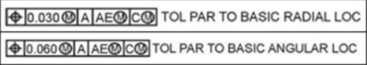

[Ri...] Posted February 17, 2025 Share Posted February 17, 2025 I got a fun one. A dual Position callout on a pattern of holes where they want a specific tolerance for the radial location, and another for the angular location. Apparently this is achievable in certain DMIS based softwares, but not easily achievable in Calypso. Thoughts? Link to comment https://qualityforum.zeiss.com/topic/22472-position-independent-tolerance-according-to-radialangular-location/ Share on other sites More sharing options...

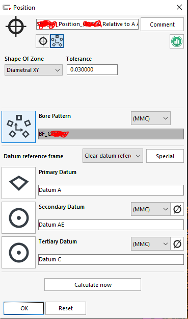

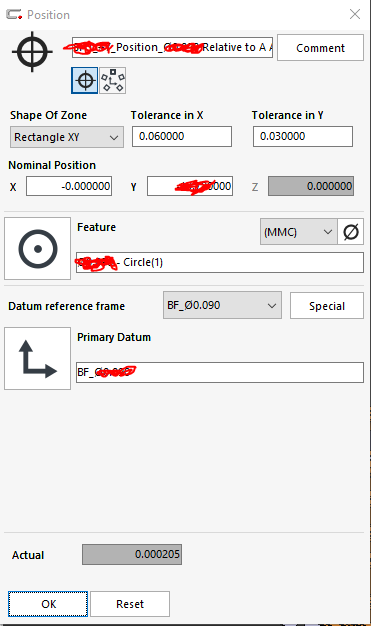

[Ri...] Posted February 17, 2025 Author Share Posted February 17, 2025 Please sign in to view this quote. Since I needed Datum Shift - here was my first stab at it. I created a Bore Pattern Position that allowed Datum Shift. Then I created individual Position callouts that referenced the Bore Pattern as the Datum. I then rotate each one to the nominal angle of the hole, and evaluate the X/Y Position independently. I wanted to new the GD&T Position, but the Simultaneous Evaluation is not very optimized, and it doesn't allow separate tolerances per direction like the original Position does, so I'd have to double the amount of characteristics which in turn makes the Simultaneous Evaluation even slower. Link to comment https://qualityforum.zeiss.com/topic/22472-position-independent-tolerance-according-to-radialangular-location/#findComment-126648 Share on other sites More sharing options...

[Ma...] Posted February 18, 2025 Share Posted February 18, 2025 (edited) Ok, now i have a vision 🙂 I wonder - what if they inteded to use rectangle tolerance? Having hole on top ( aka X=0 Y=radius ) and tolerance X=0.06 and Y=0.03? And i forgot one mention - there is no Ø sign Edited February 18, 2025 Link to comment https://qualityforum.zeiss.com/topic/22472-position-independent-tolerance-according-to-radialangular-location/#findComment-126664 Share on other sites More sharing options...

[Ri...] Posted February 18, 2025 Author Share Posted February 18, 2025 Please sign in to view this quote. The customer's legacy equipment can easily handle this callout. 😞 T(A_HOLE_ANG_TP_.06)=TOL/POS,3D,0.06,MMC,ANGLE T(A_HOLE_RAD_TP_.03)=TOL/POS,3D,0.03,MMC,RADIUS Link to comment https://qualityforum.zeiss.com/topic/22472-position-independent-tolerance-according-to-radialangular-location/#findComment-126772 Share on other sites More sharing options...

[Ch...] Posted February 19, 2025 Share Posted February 19, 2025 Kind of like with X/Y position Calypso allows you to select position in X or Y only - but I don't believe these options are available for polar features. We should request it on MyVoice. I would probably rotate to the feature so in cartesian it is on X or Y, then report X + Y individually and rename them as RADIUS + ANGLE etc. Link to comment https://qualityforum.zeiss.com/topic/22472-position-independent-tolerance-according-to-radialangular-location/#findComment-126808 Share on other sites More sharing options...
