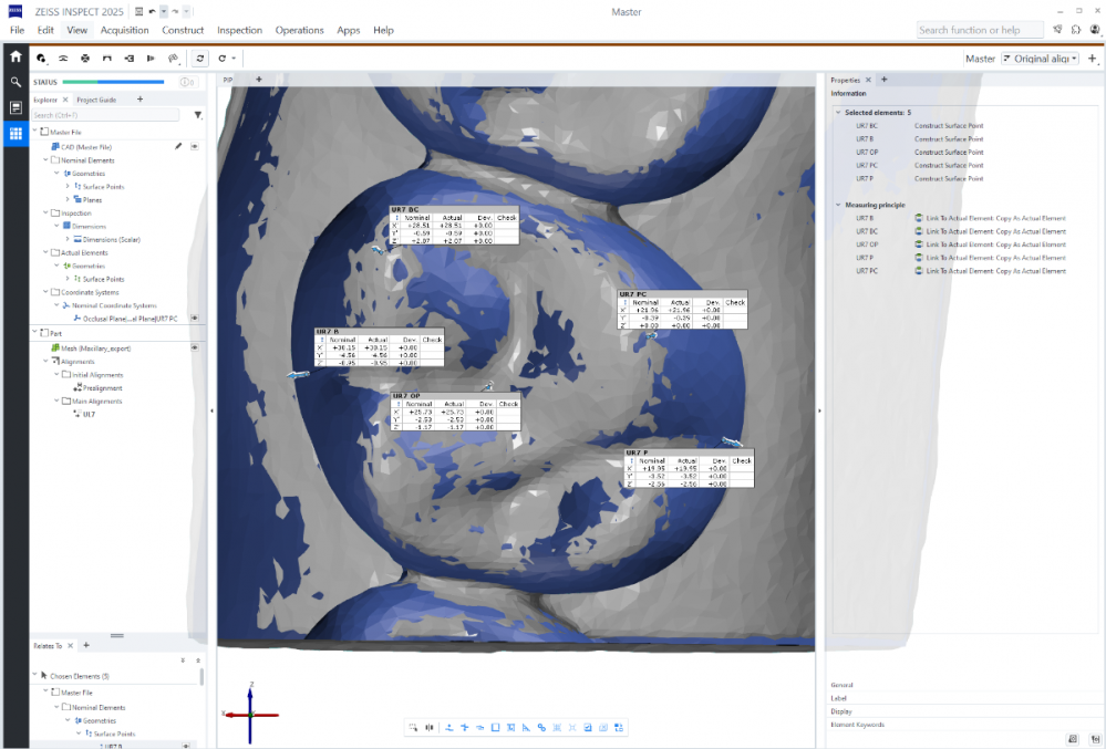

[An...] Posted February 18, 2025 Share Posted February 18, 2025 Trying to figure out why there's no deviation from my surface points. Ive currently followed these steps 1. The master file was imported using target element type as CAD Body 2. Constructed a local coordinate system 3. Selected surface points to be measured 4. Import the specimen file, using target element type as mesh and prealignment by standard best fit 5. Aligned using local best fit to minimize the deviation between two surfaces 6. Transfer the surface points; copy every point from master file and link to specimen file to ensure repeatability Link to comment https://qualityforum.zeiss.com/topic/22474-no-deviation/ Share on other sites More sharing options...
[Ja...] Posted February 18, 2025 Share Posted February 18, 2025 Hi, its because it looks like you have used measuring principle ' copy as actual element' so the nominal points end up just being linked to copies of themselves. You might want to consider converting nominal points from master file to surface points ' convert nominal element' so you can have access to measuring principles such as Intersection with mesh. Link to comment https://qualityforum.zeiss.com/topic/22474-no-deviation/#findComment-126660 Share on other sites More sharing options...

[Ja...] Posted February 18, 2025 Share Posted February 18, 2025 Please sign in to view this username. go to the actual points in the tree and delete them. Once deleted you can get access to the measuring principles. Converting the nominal points wont fix the issue , but just will give some more measuring principle options Link to comment https://qualityforum.zeiss.com/topic/22474-no-deviation/#findComment-126766 Share on other sites More sharing options...

[Ja...] Posted February 19, 2025 Share Posted February 19, 2025 I dont agree with the workflow shown in the video. You see they suggest using easuring principle Copy as actual element ...this is fundamentally what is causing your confusion. What are you trying to do? This is where spending times with an apps sepcialist would be beneficial, have you tried contacting your local team? Link to comment https://qualityforum.zeiss.com/topic/22474-no-deviation/#findComment-126784 Share on other sites More sharing options...
