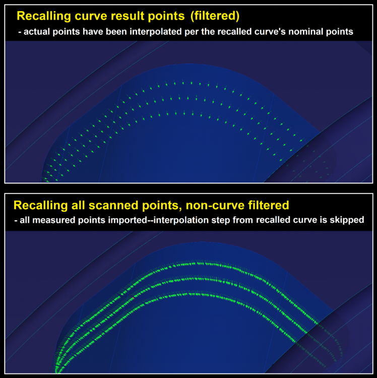

[Je...] Posted February 21, 2025 Share Posted February 21, 2025 (edited) Please sign in to view this quote. Shawn, I use this option often depending on the application. It's an important distinction between using a recalled curve feature primarily as a point container for actuals or recalling the curve-filtered points per the curve's nominals. In theory, this can make the strategy more feasible per system resources because it reduces the quantity of recalled points. It depends on the application. Another advantage is that it imports a feature whose task of interpolation is already accomplished. An example would be for evaluating profile of a freeform surface made up of multiple curves. I can explain more specific use cases if helpful, but that's the overview. Both options are important. It's definitely not the case that one option is always correct and the other is "bad." PS, the Zeiss moderators will probably relegate this thread to the purgatory known as the curve subtopic, so hopefully you're able to get your answer before that occurs. Edited February 21, 2025 Link to comment https://qualityforum.zeiss.com/topic/22522-recall-feature-points-from-curve/#findComment-126966 Share on other sites More sharing options...

[Ma...] Posted February 21, 2025 Share Posted February 21, 2025 Please sign in to view this quote. If you are recalling from curve, then this will happen: You have no actuals on curve -> nominals will be recalculated from nominal points of curve You have actuals on curve ( measured ) -> nominals will be recalculated from actuals I am using that recalculation only from curve and without actuals for making basic features from model. It's not recalculating nominals every run ( i think ). Link to comment https://qualityforum.zeiss.com/topic/22522-recall-feature-points-from-curve/#findComment-126978 Share on other sites More sharing options...

[Je...] Posted February 25, 2025 Share Posted February 25, 2025 (edited) Please sign in to view this quote. Good question, Shawn. I usually like a higher density of points to define arcs. The situations where I use curve filtering are when the underlying geometry is a set of curves such as a spline and not a true, singular circle. This usually occurs when I'm evaluating profile on a set of adjoining features such as an opening. Edited February 25, 2025 Link to comment https://qualityforum.zeiss.com/topic/22522-recall-feature-points-from-curve/#findComment-127174 Share on other sites More sharing options...
