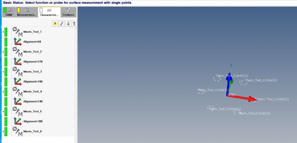

[Ch...] Posted February 25, 2025 Share Posted February 25, 2025 Well I managed to do it following Zeiss KB article : https://portal.zeiss.com/knowledge-base?id=523014 with the use of 'macros' They claim patterning a pattern won't work - I think I can understand why. However do I think someone on here could do it with a bit of crafty PCM ? - probably .. Anyways - program attached for reference - saved in Calypso 2023- its what I use as my main version - if you need v2022 let me know. Not ideal I realize, but works ! Good luck ! Pattern in a Pattrn test v2023.zip 1 Link to comment https://qualityforum.zeiss.com/topic/22528-pattern-a-pattern/#findComment-127180 Share on other sites More sharing options...

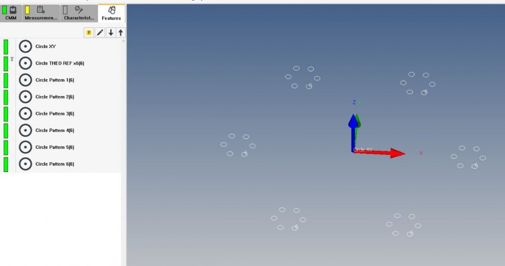

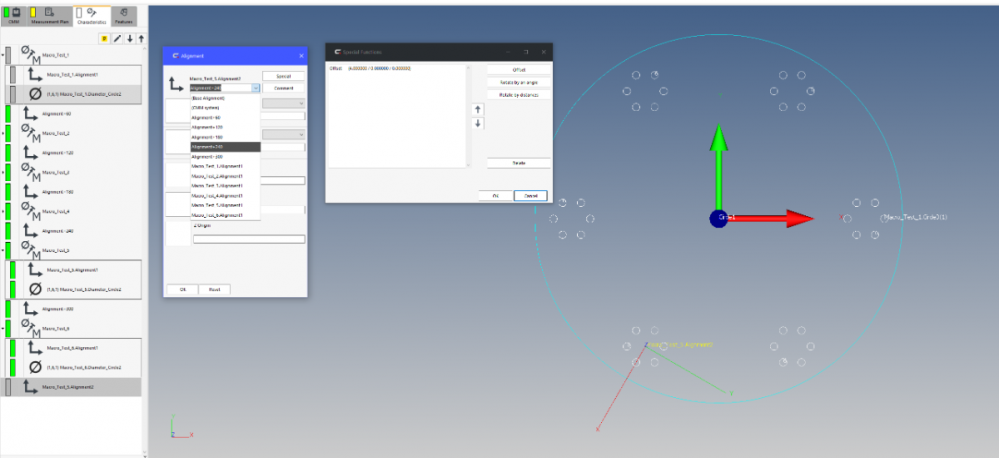

[Ch...] Posted February 26, 2025 Share Posted February 26, 2025 Here's another solution - made a theoretical feature to align to (+X) {pattern this feature 6x60° for REF) Alignment is now patterned. Circle small hole with - choose Alignment *1 Circle small hole with - choose Alignment *2 Circle small hole with - choose Alignment *3 Circle small hole with - choose Alignment *4 Circle small hole with - choose Alignment *5 Circle small hole with - choose Alignment *6 If you're not a huge fan of macros - I like that we have the option - just like to keep everything contained in same program when possible. This may be quicker programming wise as well. So can't pattern a pattern BUT can pattern an alignment. I still think there's more of a 'one shot' way of doing this - just need to think about it some more. Pattern in a Pattrn test v2022 V2.zip 1 Link to comment https://qualityforum.zeiss.com/topic/22528-pattern-a-pattern/#findComment-127275 Share on other sites More sharing options...

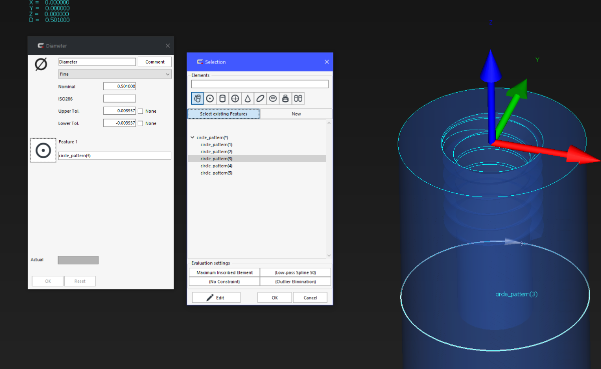

[Mi...] Posted February 28, 2025 Share Posted February 28, 2025 How to apply a different evaluation on a diameter measured with pattern? I would like to avaluate the same diameter with GAUSS and Maximum inscribed. Link to comment https://qualityforum.zeiss.com/topic/22528-pattern-a-pattern/#findComment-127495 Share on other sites More sharing options...
[Je...] Posted March 3, 2025 Share Posted March 3, 2025 Please sign in to view this quote. Hi Miguel. There are a couple different ways to apply different evaluation methods to the instances of a pattern. One method is to create a diameter characteristic and recall only one instance of your pattern: Link to comment https://qualityforum.zeiss.com/topic/22528-pattern-a-pattern/#findComment-127547 Share on other sites More sharing options...

[Mi...] Posted March 6, 2025 Share Posted March 6, 2025 Please sign in to view this quote. Thanks! If I place a condition in the feature to evaluate a pattern diameter in two ways: Gauss and maximum inscribed, will it work? Best regards, Miguel Link to comment https://qualityforum.zeiss.com/topic/22528-pattern-a-pattern/#findComment-127807 Share on other sites More sharing options...
[Mi...] Posted March 6, 2025 Share Posted March 6, 2025 Sorry, I meant to say a condition in the feature. Link to comment https://qualityforum.zeiss.com/topic/22528-pattern-a-pattern/#findComment-127809 Share on other sites More sharing options...
[Ch...] Posted March 7, 2025 Share Posted March 7, 2025 (edited) a bit off topic, but putting this condition on 2 characteristics with diff evals might be a better option - if you needed to evaluate the 2 sizes on the fly - it could theoretically possibly be done on the features side, with either recalling points and/or PCM. technically conditions can only be on characteristics I beleive. Edited March 7, 2025 Link to comment https://qualityforum.zeiss.com/topic/22528-pattern-a-pattern/#findComment-127885 Share on other sites More sharing options...
