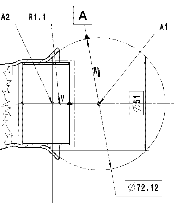

[Al...] Posted February 24, 2025 Share Posted February 24, 2025 Hi all, I've a question regarding how to interpretate the evaluation of a sphere that is a datum. Do you think use as datum 3D-line from A1 to A2 is correct? How can i evaluate it to use as datum? Link to comment https://qualityforum.zeiss.com/topic/22540-evaluation-of-a-sphere/ Share on other sites More sharing options...
[Ma...] Posted February 24, 2025 Share Posted February 24, 2025 Do you have curve? I don't think that small part is spherical. I would not recommend 3d line. Link to comment https://qualityforum.zeiss.com/topic/22540-evaluation-of-a-sphere/#findComment-127078 Share on other sites More sharing options...
[Al...] Posted February 24, 2025 Author Share Posted February 24, 2025 I don't have curve. What about to use only the A2 point? The refence datums are A and B. I try to use the 3D line as datum A and cylinder as datum B or A2 point as A and circle as B. Do you have other suggestions? Link to comment https://qualityforum.zeiss.com/topic/22540-evaluation-of-a-sphere/#findComment-127082 Share on other sites More sharing options...
[Ma...] Posted February 24, 2025 Share Posted February 24, 2025 I am not sure how your callouts looks like, but i have an idea. Before getting circle A2 you should establish main axis ( some cylinder to get close to axis A2-A1 ) Now you can get circle A2. Then you can make point A1 with calculation: simple trigonometry - R=36,06 / a=25,5 / b = √(R²-a²) = 25,4965 ( it's almost 45° ) So your A1 would be further from A2 by 25,4965. It's not common to have datums like this, but here i think that datum A is indeed 3d line from A1 to A2. Then your datum B should be circle to you be able to rotate alignment to 22,36° Link to comment https://qualityforum.zeiss.com/topic/22540-evaluation-of-a-sphere/#findComment-127084 Share on other sites More sharing options...

[Cl...] Posted February 24, 2025 Share Posted February 24, 2025 (edited) The distance between A1 & A2 is too short for a stable datum. I would measure the sphere using lots of points. That gives you A1. Then create two more theoretical points. One at 51 +X from center and one 51 -X (A2) from center. Then construct a 3d line from those three points. Edited February 24, 2025 Link to comment https://qualityforum.zeiss.com/topic/22540-evaluation-of-a-sphere/#findComment-127096 Share on other sites More sharing options...
