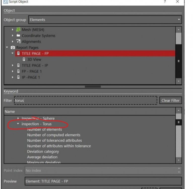

[Ti...] Posted February 27, 2025 Share Posted February 27, 2025 (edited) Torus feature please...all turned parts have torus features. Simply creating a section cut and measuring a single circle works most of the time. But then ask yourself, why do we have a cylinder feature? It is b/c we prefer 3d geometry(cylinder) over 2d geometry(circle). Same thing applies to torus features. In my opinion it is a mandatory feature for any geometric analysis software, pcdmis has it, im hearing calypso has it... We need a torus feature...I would like to measure both these torus features in one-click and do so in 3d geometry, not have to section the part and create circles, and sometimes multiple circles to average out any inconsistencies. Also, you are dealing with limited arc circles so they are unstable...using 3d geometry stabilizes the limited arc circle on a section cut. Edited February 27, 2025 Link to comment https://qualityforum.zeiss.com/topic/22581-request-for-a-torus-feature/ Share on other sites More sharing options...

[Ti...] Posted April 9, 2025 Author Share Posted April 9, 2025 I added it to My Voice 2 weeks ago. The torus feature has been looked at inside the software long ago as you can see inside GOM 2021 image above. https://portal.zeiss.com/my-voice/software/metrology/product/eaafdea8-9296-485d-82c1-cc6d1ca0eca2/request/95683414-676a-4b9b-8281-f022f01ad81c Link to comment https://qualityforum.zeiss.com/topic/22581-request-for-a-torus-feature/#findComment-129971 Share on other sites More sharing options...
