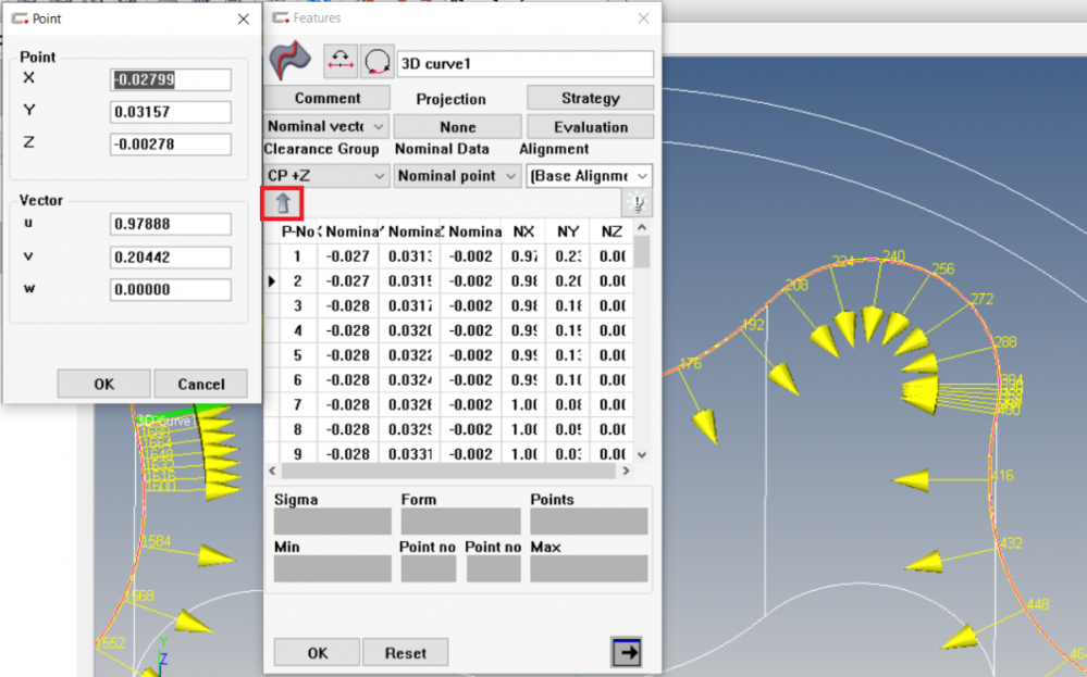

[Cl...] Posted February 27, 2025 Share Posted February 27, 2025 (edited) I have just discovered this function. I have a 3d Curve with one point with the vector reversed. I started playing around with trying to change the vector and found out how by accident. For those of you who weren't aware of this here it is. Edited February 27, 2025 Link to comment https://qualityforum.zeiss.com/topic/22593-editing-a-3d-curve/ Share on other sites More sharing options...
[Ma...] Posted February 27, 2025 Share Posted February 27, 2025 Please sign in to view this username. well i thought this is well known 😄 And if your vector is just inversed, then just right click on nominal point on list and select invert vector. I am doing most stuff in here, because not everytime you get nominals in right order from many CAD intersections. Usefull thing is cut and paste before / after. Always check whole curve for inverted vectors - i have disabled show all nominals, but for check i am enabling it to see errors. Inverted vector can lead into collision state even without collision ( same for nominal spline, curvy model and low density nominal points ) Link to comment https://qualityforum.zeiss.com/topic/22593-editing-a-3d-curve/#findComment-127391 Share on other sites More sharing options...
[Cl...] Posted February 27, 2025 Author Share Posted February 27, 2025 I've never needed to use this function. So, I never looked for, or knew it existed. Link to comment https://qualityforum.zeiss.com/topic/22593-editing-a-3d-curve/#findComment-127393 Share on other sites More sharing options...

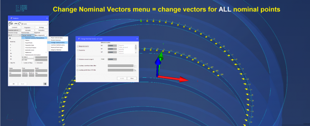

[Je...] Posted February 28, 2025 Share Posted February 28, 2025 Please sign in to view this quote. Clarke, that's very cool. I love that experience of discovery in Calypso, which I still encounter weekly after having used the software for over a decade. Another way to manipulate the vectors for all points, which perhaps you've used, is found in the drop-down menu for nominal values. Depending on the situation, this can sometimes be used to fix an errant point. Link to comment https://qualityforum.zeiss.com/topic/22593-editing-a-3d-curve/#findComment-127479 Share on other sites More sharing options...
