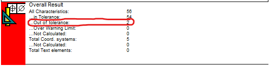

[Lu...] Posted March 10, 2025 Share Posted March 10, 2025 Hello, I know it is possible to mask a characteristic from appearing on the report, but I have noticed that it will still show calculated in the overall result. For example, if I mask a characteristic from outputting to the report and that characteristic is the only one that is out of tolerance, the overall result will still list there being one dimension out of tolerance even though that dimension is hidden from the rest of the report. is there any way to also mask the characteristic from being included into the overall result? Im on calypso 2021 (7.2). Thank you! Link to comment https://qualityforum.zeiss.com/topic/22693-mask-characteristic-on-overall-result/ Share on other sites More sharing options...
[Mi...] Posted March 10, 2025 Share Posted March 10, 2025 Commit to learning the Multiple printout, and this is one of the things that works better. To do it with the Custom printout, the only thing I ever found that worked was to set the Tolerance of the masked Characteristics to something ridiculous like 999 Link to comment https://qualityforum.zeiss.com/topic/22693-mask-characteristic-on-overall-result/#findComment-128003 Share on other sites More sharing options...
[Lu...] Posted March 10, 2025 Author Share Posted March 10, 2025 If by multiple printout you mean the PIWeb reports (I'm not correcting you, I'm just making sure that's what multiple printout is, I'm pretty new) then sadly neither of those will work for my situation, though I very much appreciate your response. I'll probably just end up taking off the overall result if nothing else will work. Link to comment https://qualityforum.zeiss.com/topic/22693-mask-characteristic-on-overall-result/#findComment-128011 Share on other sites More sharing options...
[Mi...] Posted March 10, 2025 Share Posted March 10, 2025 They work if you make them work, and the warning is, in the not to distance future you will have no choice. So I highly recommend you learn how to convert them. My and my counterpart converted a few thousand programs in the last year. Link to comment https://qualityforum.zeiss.com/topic/22693-mask-characteristic-on-overall-result/#findComment-128013 Share on other sites More sharing options...
