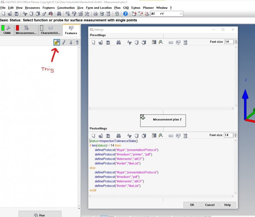

[Ju...] Posted March 11, 2025 Share Posted March 11, 2025 Is there a way to only print a report if there is a characteristic out of tolerance? I set the report to out of tolerance only but when everything is in tolerance it still prints off the header. The only time we need a printout is if something is out and I thought this would be easier than asking the operators to manually print a report whenever needed. Link to comment https://qualityforum.zeiss.com/topic/22699-saving-paper/ Share on other sites More sharing options...
[is...] Posted March 12, 2025 Share Posted March 12, 2025 (edited) Hi Justin! Try this, put in in the post settings. status=inspectionToleranceState() if len(status)==14 then defineProtocol("#type","presentationProtocol") defineProtocol("#medium","printer", "pdf") defineProtocol("#elements","allCF") defineProtocol("#order","likeList") else defineProtocol("#type","presentationProtocol") defineProtocol("#medium","pdf") defineProtocol("#elements","allCF") defineProtocol("#order","likeList") endif Edited March 12, 2025 Link to comment https://qualityforum.zeiss.com/topic/22699-saving-paper/#findComment-128107 Share on other sites More sharing options...

[Ju...] Posted March 12, 2025 Author Share Posted March 12, 2025 Please sign in to view this quote. Thank you Isagani for the suggestion! I am not sure where to find post settings. Is this a PCM thing? Link to comment https://qualityforum.zeiss.com/topic/22699-saving-paper/#findComment-128183 Share on other sites More sharing options...
[is...] Posted March 12, 2025 Share Posted March 12, 2025 It's PCM. Link to comment https://qualityforum.zeiss.com/topic/22699-saving-paper/#findComment-128185 Share on other sites More sharing options...
