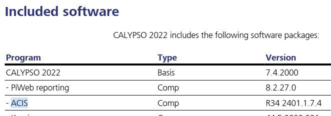

[na...] Posted March 17, 2025 Share Posted March 17, 2025 (edited) Please sign in to view this quote. A search of ACIS in release info will show it -> https://portal.zeiss.com/download-center/softwares/imt/software/9533 Edited March 17, 2025 Link to comment https://qualityforum.zeiss.com/topic/22703-cad-file-will-not-load-calypso-2021/#findComment-128373 Share on other sites More sharing options...
[Do...] Posted March 17, 2025 Author Share Posted March 17, 2025 Please sign in to view this quote. Great find Please sign in to view this username. ! I had only looked at the "CAD Interfaces" portion of the document and did not see ACIS nor .sat listed under formats. I did not think to search the document for ACIS. I've gone through and tested the versions again. Calypso 2021 accepts ACIS versions R32 and below. The file size I was testing was fairly large and took time to load in. That delay had led me to believe I needed to continue downgrading versions until I reached 17 which seemed to load in slightly quicker. Link to comment https://qualityforum.zeiss.com/topic/22703-cad-file-will-not-load-calypso-2021/#findComment-128429 Share on other sites More sharing options...
