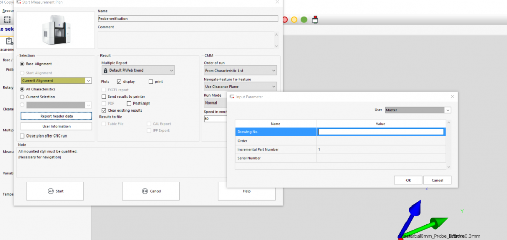

[Er...] Posted March 11, 2025 Share Posted March 11, 2025 Hi, I'm new to Calypso and would like to have a prompt for an incremental part number at the start of every programs. Sometimes, the parts inspected are not in the right order and we need to manually change it. I know that you can have access via Report header data, but I would like to have a prompt when clicking on start. Thanks for your help! Link to comment https://qualityforum.zeiss.com/topic/22705-part-number-prompt-at-the-start-of-every-program/ Share on other sites More sharing options...
[Je...] Posted March 12, 2025 Share Posted March 12, 2025 first go to Measurement->Multiple Report->Select Report Header Parameters and set check at the Run-column of Incremental Part Number then go to Resources->Report Header Parameters and check Force Input at Start (lower left corner) Link to comment https://qualityforum.zeiss.com/topic/22705-part-number-prompt-at-the-start-of-every-program/#findComment-128085 Share on other sites More sharing options...
[An...] Posted March 12, 2025 Share Posted March 12, 2025 Just an amendment to this: Force Input at Start actually just stops shy of forcing input. You can click past it and the program will run just fine. I think in most cases this will do what you want, but it is something to be aware of. Link to comment https://qualityforum.zeiss.com/topic/22705-part-number-prompt-at-the-start-of-every-program/#findComment-128171 Share on other sites More sharing options...
