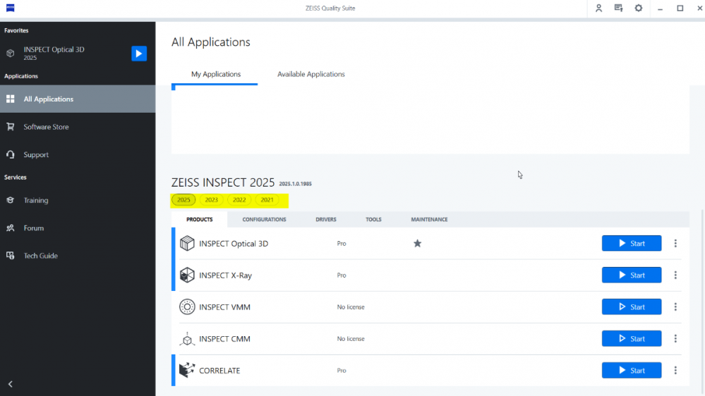

[Ti...] Posted March 12, 2025 Share Posted March 12, 2025 Does anyone know if updating to Zeiss 2025 will still give access to GOM 2022? I thought that I had read somewhere that you could not access GOM 2022 if you updated but I cannot find the information anywhere. Thank you Link to comment https://qualityforum.zeiss.com/topic/22725-zeiss-2025/ Share on other sites More sharing options...
[Mi...] Posted March 13, 2025 Share Posted March 13, 2025 If you update to 2025 you will still have access to the 2022 software. Starting in 2021 the software lives within the ZQS, so you will have 2022 and 2025 to choose from. I personally have 2021, 2022, 2023 and 2025 all within my ZQS. Please note that our software is not backwards compatible, meaning a project opened and saved within the 25 software can not be opened within the 22 software. However the 22 projects will open within 25 just fine. Link to comment https://qualityforum.zeiss.com/topic/22725-zeiss-2025/#findComment-128227 Share on other sites More sharing options...

[Yu...] Posted April 6, 2025 Share Posted April 6, 2025 Hi , How can I get free (14 ... 30 deys) / Viewer license in Zeiss inspect optical 2025? Trial program. Why doesn't the trial program download work? Nowhere. Thanks. Link to comment https://qualityforum.zeiss.com/topic/22725-zeiss-2025/#findComment-129743 Share on other sites More sharing options...
[Ch...] Posted April 7, 2025 Share Posted April 7, 2025 Hi, it should be possible to get the 30 days trial via ZEISS Quality Suite – Your digital measurement technology platform or software-store.zeiss.com. If download of ZEISS INSPECT 2025 is not possible within ZEISS Quality Suite, it may be downloaded in portal.zeiss.com. Link to comment https://qualityforum.zeiss.com/topic/22725-zeiss-2025/#findComment-129799 Share on other sites More sharing options...
